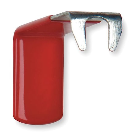

I have 2 types of plug boot pullers
Westward Spark Plug Boot Puller, 5 3/4 In L 2GKR9
Main product photo
The top one I have had for a long time and I think it works better though harder to use sometimes. It pulls on the boot which pulls the connector off. The pliers I have had it pull the connector off the wire.
The heat shield is a PITA.
Edited by diyer2
Where did you get that first one? And do you know what brand it is? I may go get one of those for my collection of tools.
Nevermind, I found one at Amazon for $4.99. Thanks for the heads up.
