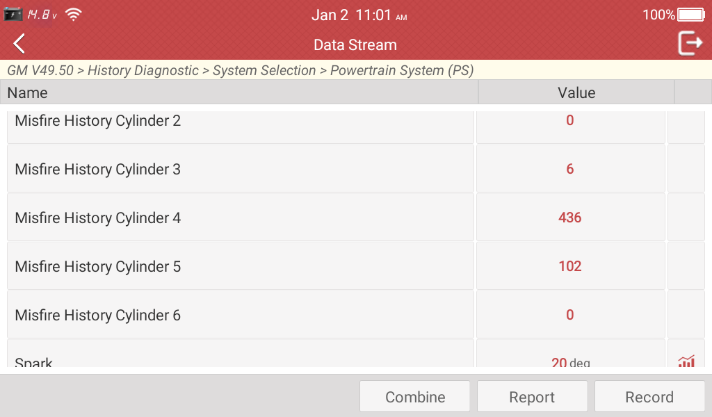

1.5 Years ago - I finally decided to put the truck in a local shop to chase the CEL that illuminated LITERALLY a day before I was going to take it in for annual state inspection.
Several things were addressed and fixed by the shop (intake resonator box had air leaks causing lean conditions, fuel pump & FPR changed, evap canister, injectors changed & upgraded to the newer style)... I myself changed plugs, wires, distributor cap, ignition coil, water pump, and fan clutch (All were suspect - and way past time to have replaced them...
A P0300 still is a ghost that occasionally appears, though. I've narrowed it down to happening generally when the engine is under higher load. (i.e. driving up a slight hill if it's a mile or longer - the check engine light will flash, then turn off once the load has been reduced on flatter (or downhill) terrain) I picked up a scanner to read live data for the misfires, and it looks like Cyl 4 is the main culprit. (see screenshot - and I did reset the numbers while on my trip)
With cyl3 & 5 also having some misfires along with 4 - but not nearly as bad. When this happens - I feel NO change in the engine performance. No shake or roughness at all that I've noticed.
I'll do the obvious quick checks this weekend to check plug/wire and distributor cap (since firing order is 1,6,5,4,3,2 - with 4 having the other offenders (3 & 5) on either side of it's firing order... but was curious if anyone had other ideas for me to check.... Could it be PCM, if it's not the obvious spark plug/ dist. cap ?
I'll do the obvious quick checks this weekend to check plug/wire and distributor cap...
I wouldn't even look at the PCM as a potential culprit.
You're on the right track - and if memory serves correctly - the cap and rotor style can foul up pretty quick.
In any case using plug wires other than AC Delco is a risk. In that generation the engine weren't so sensitive to plugs as the newer ones.
Thanks!   I'll definitely go that route for checking.   It was also suggested to me that it could be some lash from a slack/stretched timing chain.   I know that the chain has never been changed... and with almost 400k miles on it...
I would expect more widespread miss fires if that were the case.
