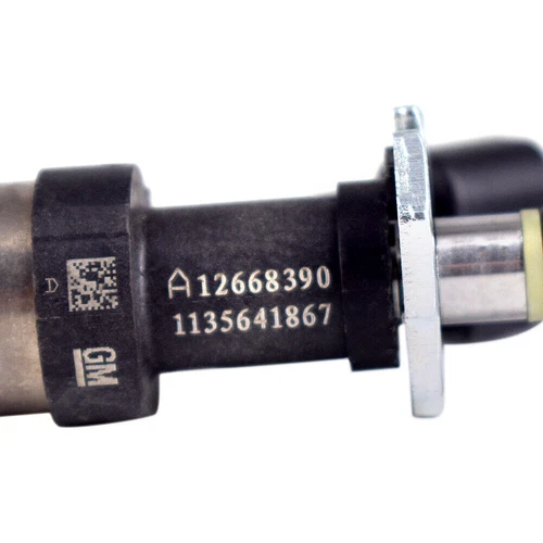

Are you buying these?  8pcs Genuine 12668390 GM Fuel Injectors For 14-19 Chevrolet GMC 1500 5.3L FJ1217 | eBay
I hope not...Those are NOT "Genuine GM", especially not for $140 for all 8 of them.  Those are counterfeits/aftermarkets made to look GM.  The packaging alone isn't even correct.
12710481 is the current OE number.  There are many legitimate places they can be purchased from at a discount, but are about $80-110 each from legit sources.
Here's the labeling on the OE injectors:
Compare that to the ones in that Ebay link:
8pcs Genuine 12668390 GM Fuel Injectors For 14-19 Chevrolet GMC 1500 5.3L FJ1217 - Picture 11 of 13
The GM logo is incorrect, the font for the "A" and the font of the casting # on the body don't match.

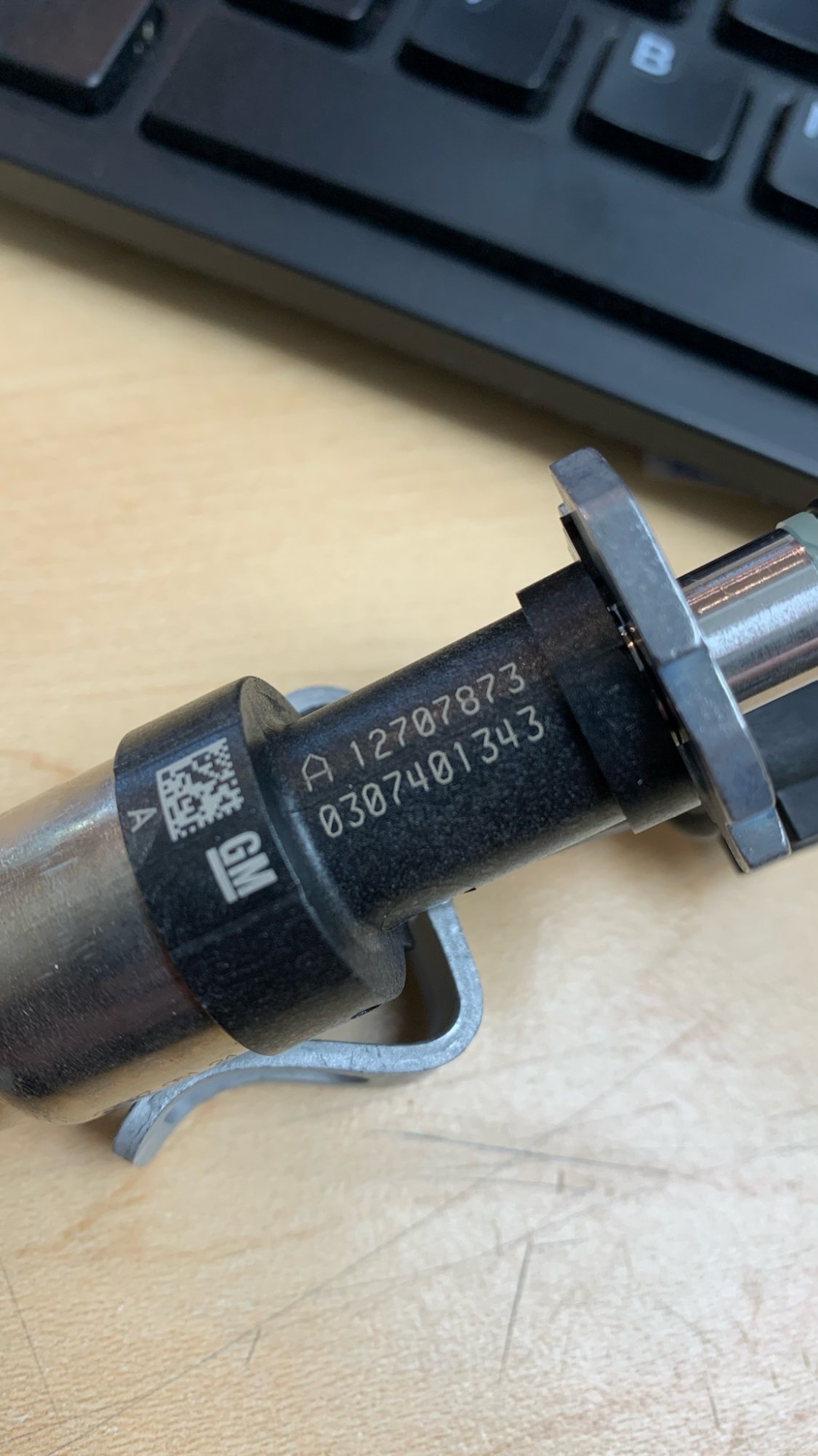

Yes, I must that due to the cost savings, I unknowingly fell for the $140 set of 8 "GM" injectors. Below I posted a pic of one of my original injectors and then one of the ebay specials. On the original factory injector, it is clear the font height of the letter A is above that of the part number that follows, on the ebay injector the height of the A is even with the height of the part number. Also, the number on the second line below, is the same on all of the ebay injectors (0615606065). Whereas on the original factory injectors, that number on the second line is different on each of them. I don't know if that means anything or not.
You were the first person to enlighten me about fake aftermarket injectors and since I've had others tell me the same thing. At this point, I am considering sending all 8 of the original factory injectors off for testing, and then only replacing those that fail the test. As I recall, nothing improved when I installed the first set of "GM" injectors and it seems that the misfiring went from intermittent to constant all the time. Before that, I recall driving the truck for perhaps several days and maybe a few hundred miles between misfire flare ups. That hasn't been the case since, it is missing right from initial cold start up and does not go away even breifly.

It isn't just the "A" that is off but several of the numbers as well. Different are the slash in the 0, as well as the font in the 2, 3, 6 and 9. It really sucks that so many fake parts are out there floating around.
I'd be curious how much a profit can be made selling fake substandard parts at substantially less than their copied twin. Obviously it must be decent or it wouldn't be happening.
Yeah, I hadn't notice that, but you are right. Also, if you look at the numeral "1", the factory injector has simply a straight line going down to the bottom, while the fake one has horizontal base at the bottom of the number. I too wonder how they can make money off counterfeiting these because surely it takes a certain amount of time and expense to make a duplicate that looks this close to the original, then they sell a set of 8 for just a tad more than one normally costs.

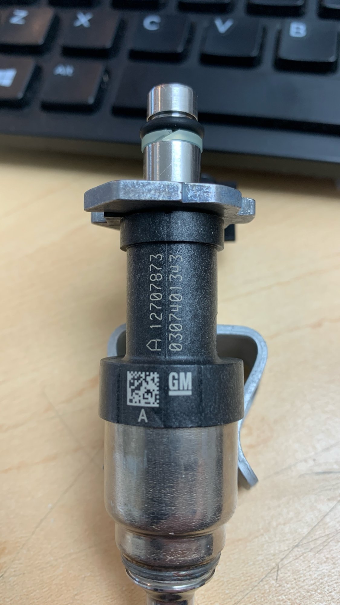

Just an FYI
The shape and size of the letters & numbers on the injector is inconsistent from AC Delco and may not be counterfeit parts.
I've just ordered a new AC Delco injector from Autozone part number 19420316.
Part# on the injector is A 12709470, this replaces 12668393.
I bought the truck a year ago and it looks like one of the injectors was replaced (see image below of injector still installed in the rail)
You can see a variation in the size and shape of the letters and number. The new injector from Autozone, should be genuine AC Delco and the old one has been functioning for more than a year and 18k miles. So, I don't believe it's a cheap Chinese knock-off.
So, I'm wondering if AC Delco has variations in their manufacturing.
I noticed a similar variation when I ordered two front wheel speed sensors and the packaging and labeling was slightly different from each other. Which made me suspect one may be a counterfeit, but the sensors are both working fine now for months.

Yes, there certainly appears to be some inconsistencies with the fonts, numbers, etc, but I think the primary red flag on these injectors is the very low price compared to dealers and other jobbers. I think the old saying, "if it seems too good to be true, it probably isn't" applies here.  Selling 8 "OEM" injectors at a cost just slightly higher than one normally costs, is not normal. But due to being on a tight, fixed income, I fell for it. Now I'm spending more than if I had just bought genuine GM parts to begin with. It is possible that introducing counterfeit parts (plugs, wires, sensors, and injectors) may be most if not all of my drivability problems. I anxiously await the results of the injector testing.
