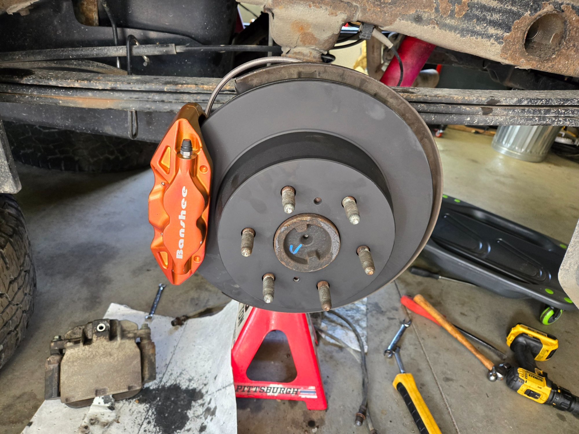

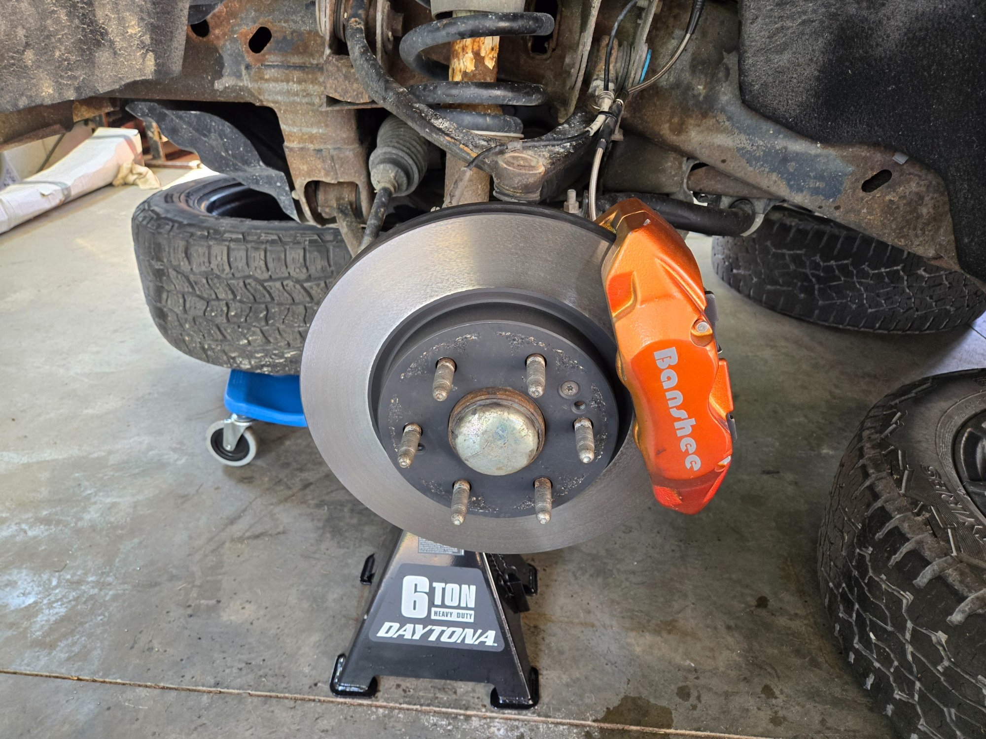

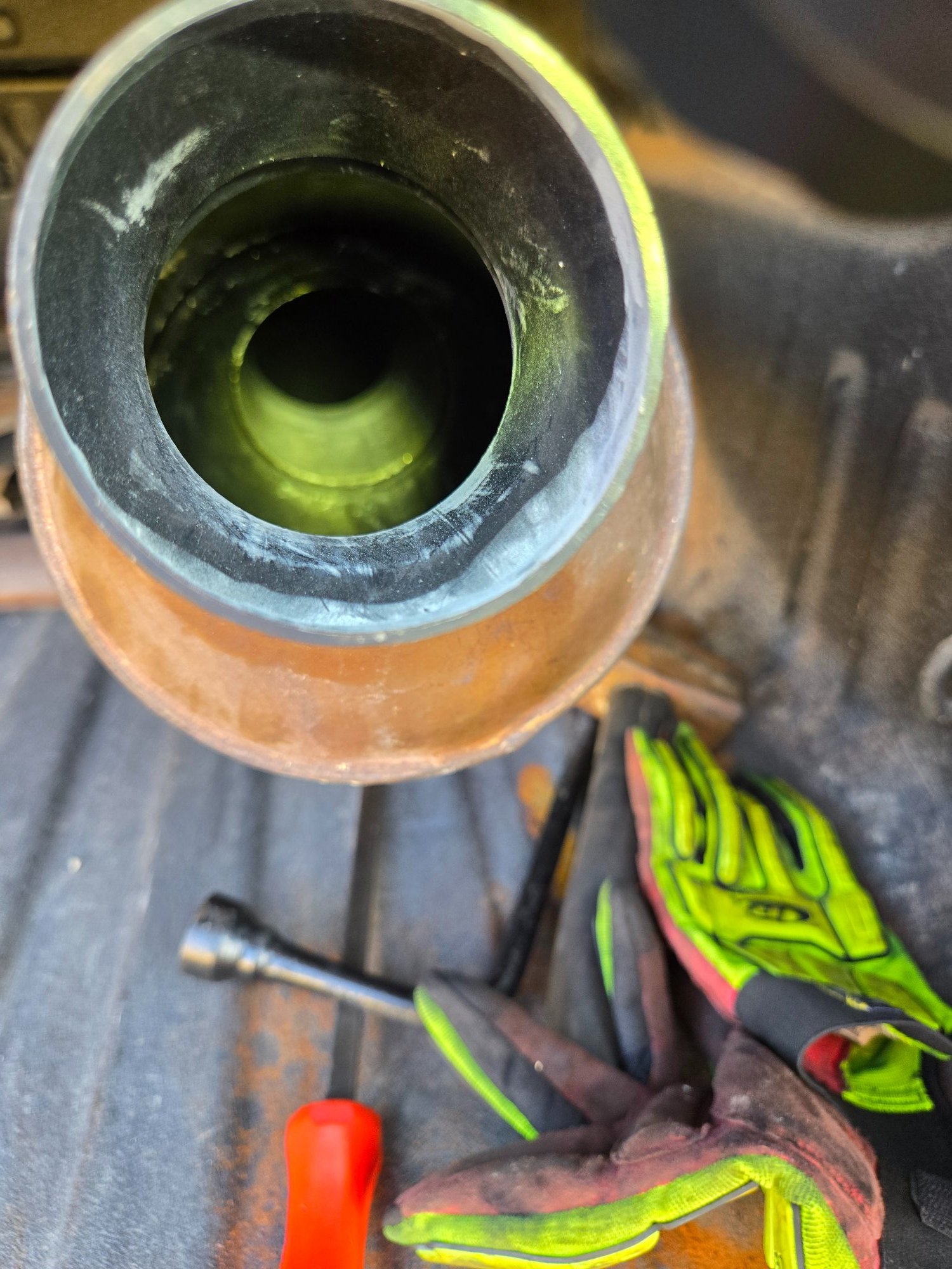

Ok so the brakes are done. I had a issues with a couple of the brake calipers that I put on passenger front leaking. I managed to piece a non leaking 1 together out of the 2 I tried on the front passenger side. In Summation I recommend getting 2019+ wheels when doing the upgrade if you're current wheels don't clear. That would save the hassle of grinding off the hump everytime you need to swap out the calipers. Once I finish swapping out the trans pan and shaking out the restriction in my exhaust, I will post results of how it stops. It should be 100% better the old brake fluid was practically water according to the tester.
Picture of restriction free pipe.20240804_175043.thumb.jpg.24e6b5bd31fcf96c1ced9f5466d5594e.jpg

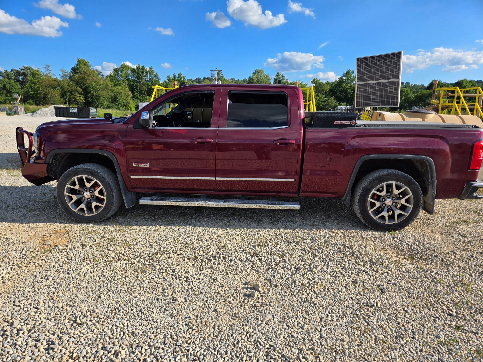

The Screaming Banshee is back in the wild. It stops on a dime and gives you 9 cents change. 20240810_180746.thumb.jpg.9351ae13c2d914c3447719afa658b8bd.jpg

I'm glad to hear your truck is back on the road. So, what are your thoughts on how quickly the truck stops now? Is the pedal stiffer, the same, or a little more squishy? Was the juice worth the squeeze?
I think it was worth it. Pedal is a good firm Pedal. It was squishy before I believe because the brake fluid needed changed. I also deleted the vacuum pump so applied pressure might require a little more push. It does stop on a dime and gives you 9 cents change. Also while it was out of service I ordered a custom thermostat housing that uses a ls3 style thermostat for the truck.  I installed a gates 187° stat turns out everyone was wrong I don't need head gaskets. The 3 motorad thermostats I used were all junk and not opening. Truck runs at 186°, it got up to 188° when I run it up to 100 mph for a few miles. (The highway was empty so only I was in the danger zone) so now I have new heads, gaskets and rockers and lifters I don't need and can't return.
