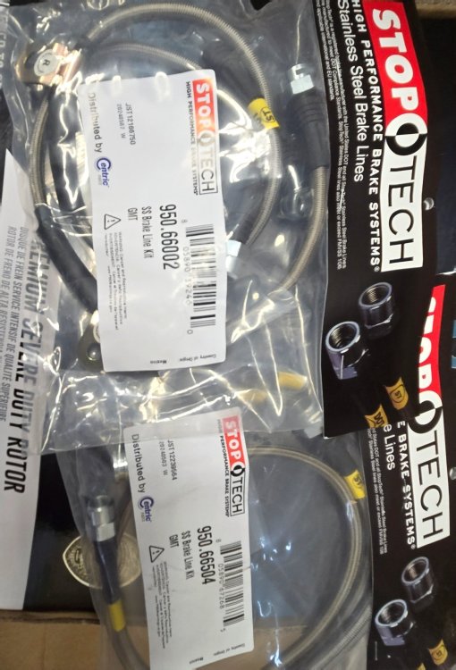

Decided to go with some stainless steel Braided brake Lines since I'm going to be changing everything else. Also ordered new brake fluid.
Motul (5 Pack) 100950 100% Synthetic Brake Dot 5.1 Brake Fluid 1/2 Liter or 500 ml https://a.co/d/0c0ZA5W0
 StopTech (950.66002) Brake Line Kit, Stainless Steel https://a.co/d/02ATSKHH
Stoptech 950.66504 SS Brake Line Kit https://a.co/d/08zn8UU1

Brake lines arrived today.
20240625_140205.thumb.jpg.8f9e3c2fbdfcc36df88817dc99cc80fa.jpg20240625_140355.thumb.jpg.99838b6c6bb40df2b32fbb6b322d0c11.jpg20240625_141745.thumb.jpg.6fad3bd41fa7c108a3e8607200985701.jpg
