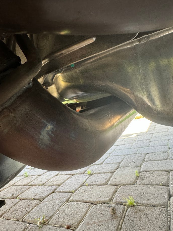

Need to investigate first. Nobody specifically states that the diesel pan will fit on a gas transmission yet since the 10 speed just came out with the gas engine. The two issues is the pan bolt up itself and the area where the exhaust crosses. It looks like where the exhaust crosses will be fine.
I have already had discussions with the people who make the pan and they think it will be fine. By the time I actually need it, they will know for sure.
Unfortunately, some other pans, like the PPE, won't fit because of the exhaust crossing.

No one seems to want to look under there 4 door. I have verified that on the regular cab the exhaust isnt a problem to be able to drop and remove the pan, without doing anything with the exhaust.
It may be possible. I was just stating what the manual says. Yes...I have looked the very first day I brought my truck home 5 months ago.
I will try first without moving the exhaust. If it doesn't work, then I disconnect the exhaust from the manifolds an lower it slightly.

Just confirmed that the OEM 10 speed pan for both the 6.6L Gas and the 6.6L diesel are identical so the aftermarket pan will bolt up fine. The only issue would be the exhaust pipe clearance so I will need to confirm that.
I havent really dug into this much but I know from previous experience that you can often gain enough clearance by backing the trans mount screws out and jacking the tail of the trans a little. That would be much easier than trying to pull the exhaust loose.  I also need to look at the service directions to see where I want to put the plug. My plan is to drill a small hole in the pan to drain it so it saves me the shower of fluid when I drop the pan. I have to drill a hole for the drain plug anyways so I may as well make it work.
