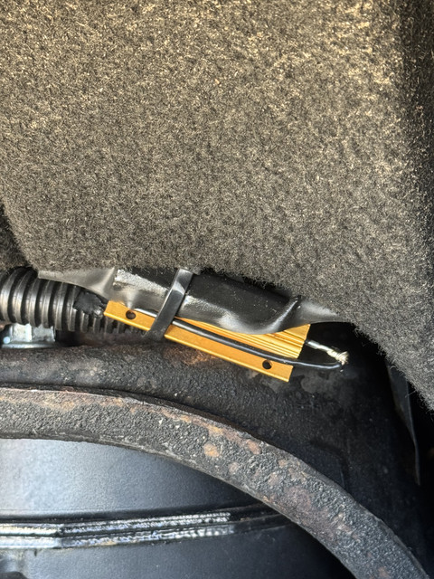

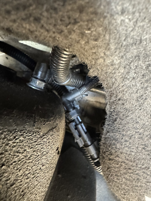

So there is a yellow resistor on the driver side where the strut goes. The truck does come equipped with magneride. There is also a loose connection that comes from the top of the strut and I don’t see where I should plug it up to anywhere. I checked the passenger for reference and it was different the passenger had another wire with a clip to where I could clip it back together. I’m not sure if the one that’s loose on the driver side goes to where the resistor is at? I also got a service suspension warning once that’s what made me check the suspension. Does anyone know if that’s where the connection go? And how would I go with putting it back to how it should be thank you!
driver side.

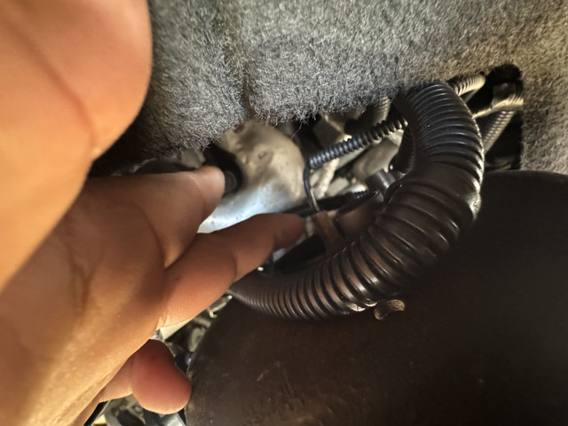

this is how the passenger side looks like
Do you have any LED lighting on the front of the truck? That is not stock, and looks like its for LED's and not the magneride suspension.

Looks like the Magneride has been bypassed, at least on that shock.
Any part # tags on that strut assembly that you can see?
