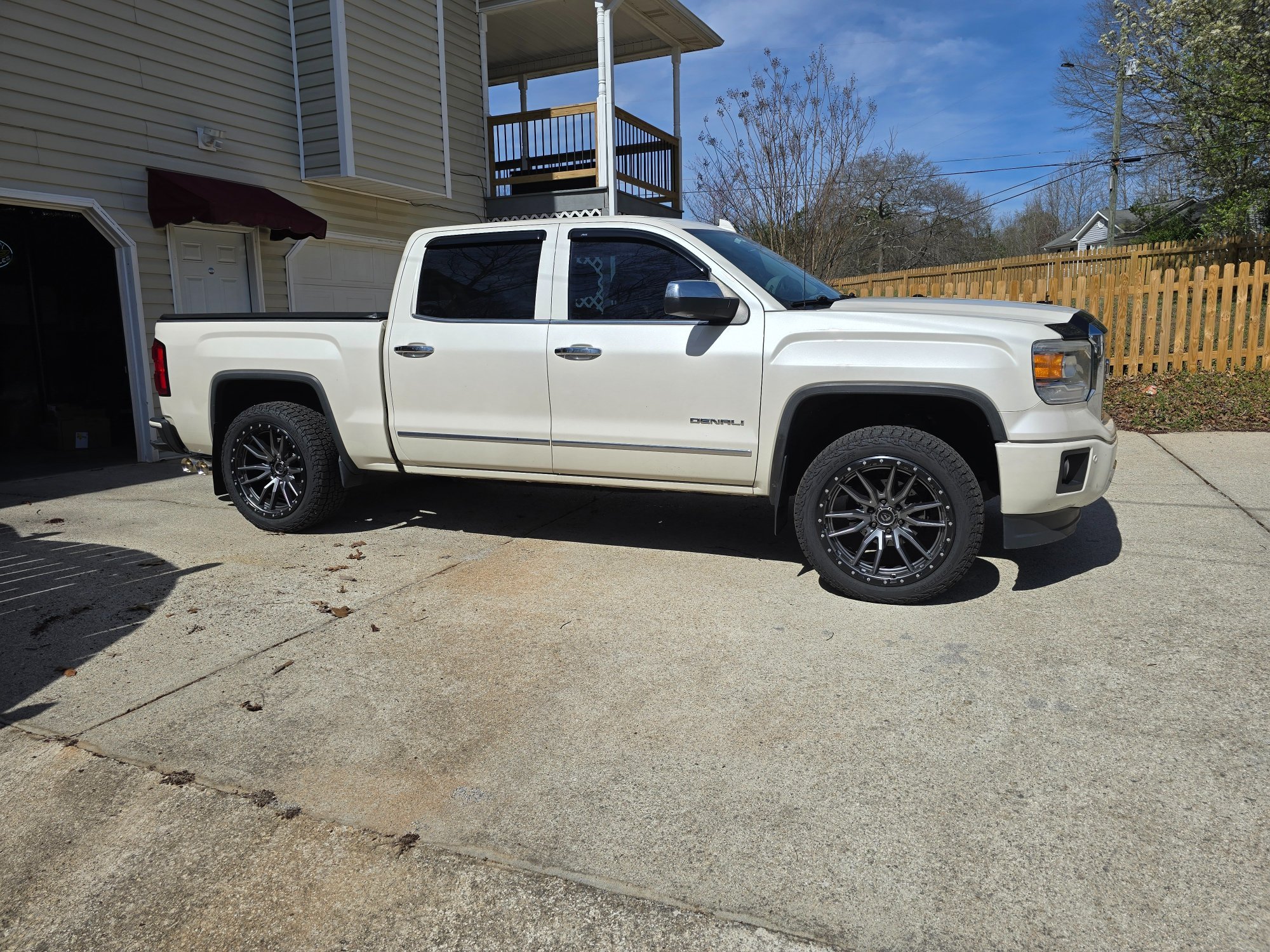

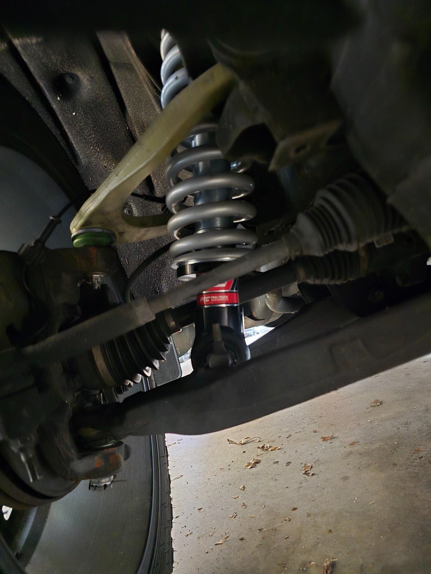

I replaced Magneride with Eibach's new stage 2R coilovers and rear shocks. The coilovers are height adjustable and at the lowest setting it levels the truck perfectly. I imagine the highest setting would raise the front way above level.
The ride is significantly better in every way. It handles better and takes bumps softer.
My stock front springs were 600lb and the the Eibachs come with 700lb.
Amazon sells a 3 ohm 100W resistor to fix the suspension warning light.
