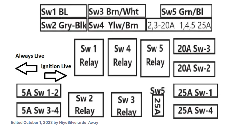

One other way to do this install is to start with the Upfitter kit. The additional fuse box allows for 4 of the switches to be on all the time or ignition controlled.
I just installed my Blackvue dash cam off this system and it works as expected.
The challenge is going to be installing the upfitter kit which is a bigger job.

I parked the my truck after returning from at trip yesterday and left my dash cam switch turned on (by mistake). Tonight I noticed my dash cam was on so I turned it off. I am using AUX 2 for the dash cam and it can be configured to be hot all the time or controlled by the ignition.
Are you referring to the upfitters setup,  if so see below:
@KTDanforth Yes, I have the dashcam hooked up to the AUX 2 switch. It is currently setup as "Always On".
I noticed the camera was on as I passed by the truck at night. I am going to switch these to "Ignition Live" and just leave the AUX 2 button pushed.
I don't want to kill the batteries!
