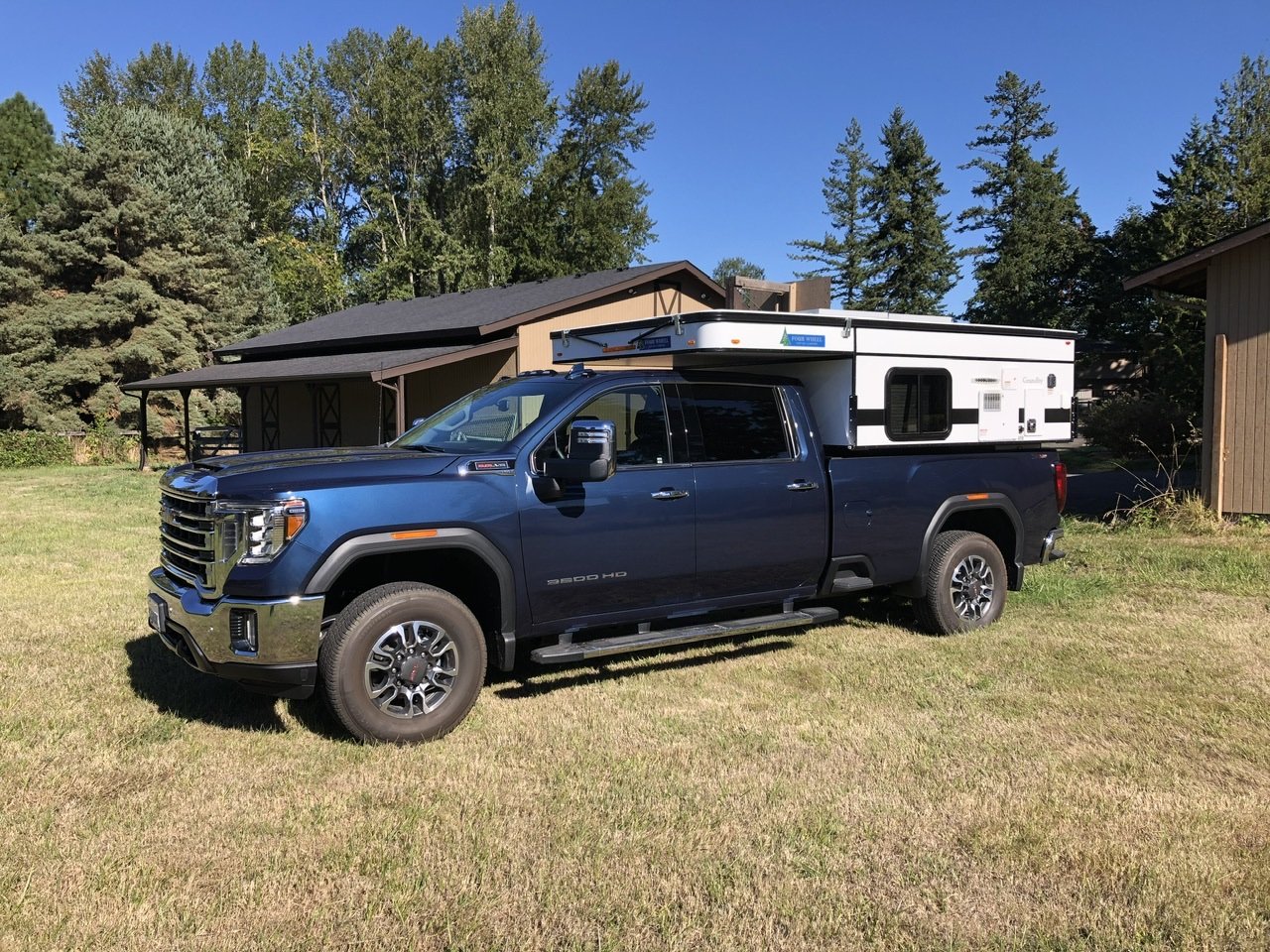

I’ve posted pictures before, but I’ll join in:
2021 Four Wheel Campers Grandby Front Dinette pop-up camper on a 2021 GMC 3500HD CCLB gas SLT SRW. The tailgate is in a crate in the garage. The camper is pretty fully optioned, so it weighs 1900 lbs with water and propane full and all our typical camping stuff loaded, and around 2000 lbs with food for a long trip. The truck payload rating is 4055 lbs.  The vehicle height with the top down is 8’ 1”, so it fits in my barn.
In static conditions, the camper puts 100 lbs on the front wheels and the rest on the rear wheels. The camper “levels” the truck nicely and the third stage “overload” springs on the rear are not engaged except when i go over a significant bump. It rides very nicely with the camper on. I have made no suspension modifications other than removing the 5600 lb rated front camper springs I ordered and replacing them with the standard 5200 lb rated springs for that model.
My granddaughter named the truck “Frederick,” and the camper is “Frederick’s Backpack.”
