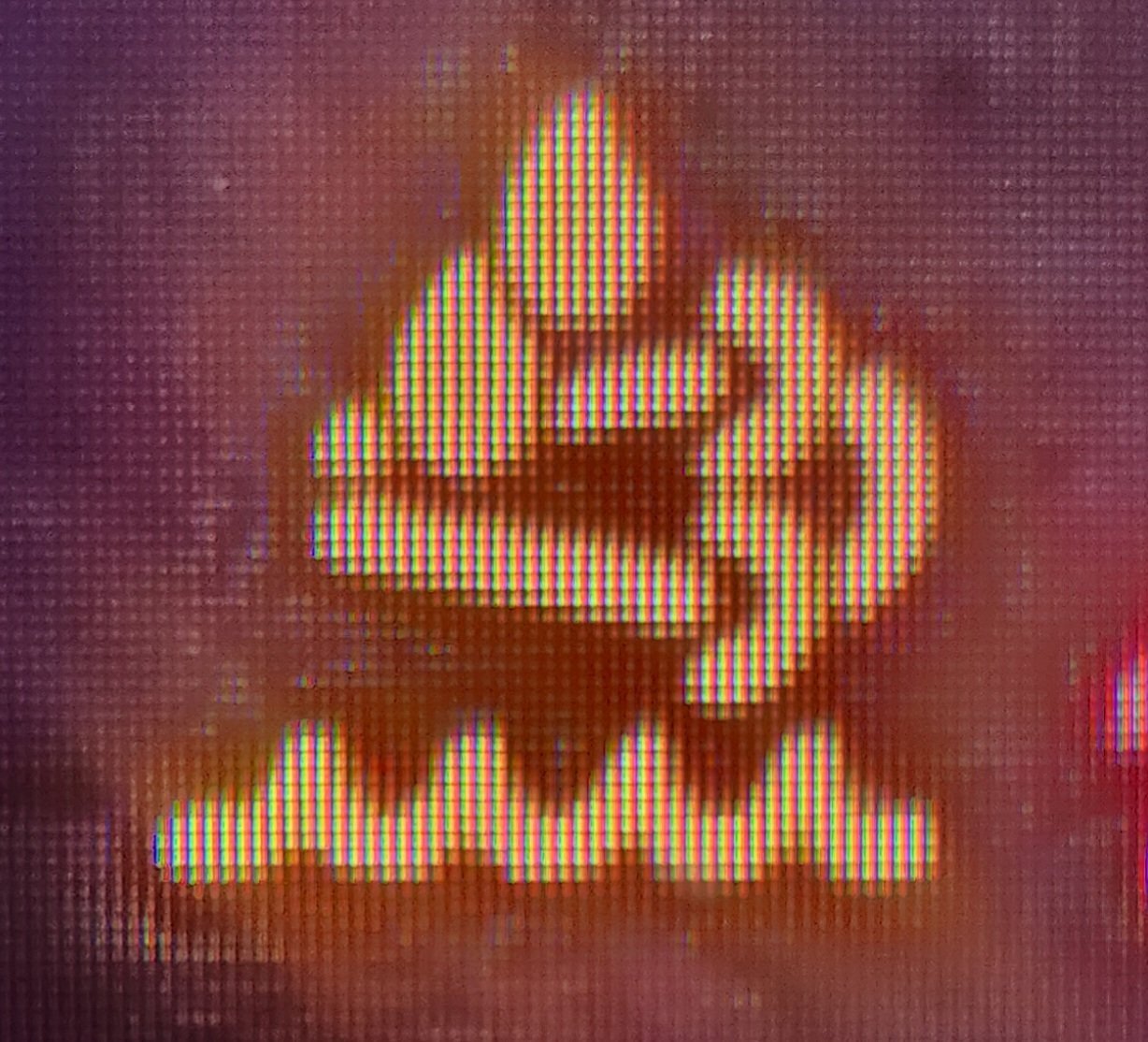

You have bad quality DEF in the tank. Often it will go away when Temps warm up. If it doesn't, the tank will need to get drained.
