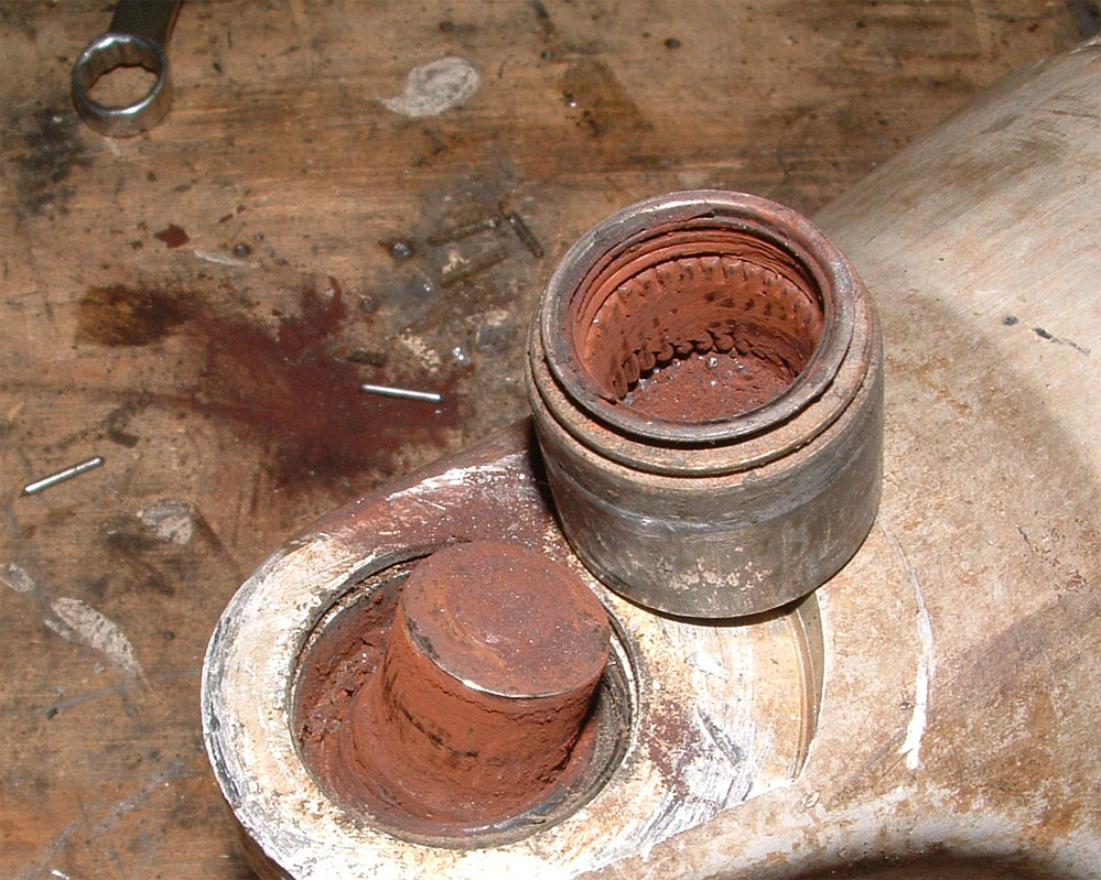

Wingnut Posted April 23, 2005 Posted April 23, 2005 Hey guys, do you guys think this ujoint was bad? Total PITA to get out of there due to the rust.
BBSilverado Posted April 23, 2005 Posted April 23, 2005 I take it that was a non-greaseable u-joint. or did someone just neglect it?
Wingnut Posted April 24, 2005 Author Posted April 24, 2005 was that out of your blazer or truck? <{POST_SNAPBACK}> It came off the '02 And No, there weren't any zerks on them.
sincityZ71 Posted April 24, 2005 Posted April 24, 2005 was that out of your blazer or truck? <{POST_SNAPBACK}> It came off the '02 And No, there weren't any zerks on them. <{POST_SNAPBACK}> oy!!...I don't even wanna know what mine might look like after seeing that...In fact I don't want to know i think...it would be one more thing to add to the ever growing list of things going wrong with the truck that is becoming annoying as hell...
Wingnut Posted April 25, 2005 Author Posted April 25, 2005 I'm not sure how only that one rusted, the other three on that joint were just fine, as were all four on the other end of the shaft. I guess the grease just got out of it somehow. At least now I can grease them. In other news, don't let the auto parts store sell you two identical ujoints for an '02 with a single drive shaft. The two joints have different part numbers, and yes, they are different. I'm just lucky that I have a second vehicle to drive to the auto parts store to get more parts when one truck has no drive shaft in it....I guess I could have still driven the '02 to the parts store by putting it in 4wd.

Indy Posted April 26, 2005 Posted April 26, 2005 I am curious...What are the symptoms of a bad U-joint? I have order parts to change bearings, tie-rod ends, and upper/lower ball joints due to torn grease boots, poping sound on turns, and grinding and road noise...All due to a lot of off roading.... Would the U-joints be next?? <{POST_SNAPBACK}> Bad u-joints usually start to squeak or chirp. The chirping speeds up the faster you go until you can't really hear it at cruising speed. Mine were gone in about 50,000 miles on my '99 Sierra and I replaced them with greasable ones.
Wingnut Posted April 26, 2005 Author Posted April 26, 2005 I've had ujoints go bad with zero symptoms before asploding. Usually, they vibrate at very specific speeds, like between 68 and 72 mph...Not at 67, and not at 73...Never under load, only when coasting. (At least that was what one set on an '89 that I had did.) When the ones on the '92 went bad, they were just clunking something fierce when going into gear or reverse, along with a lot of slack in the drivetrain. This time around, it was the squeeking as mentioned above.
