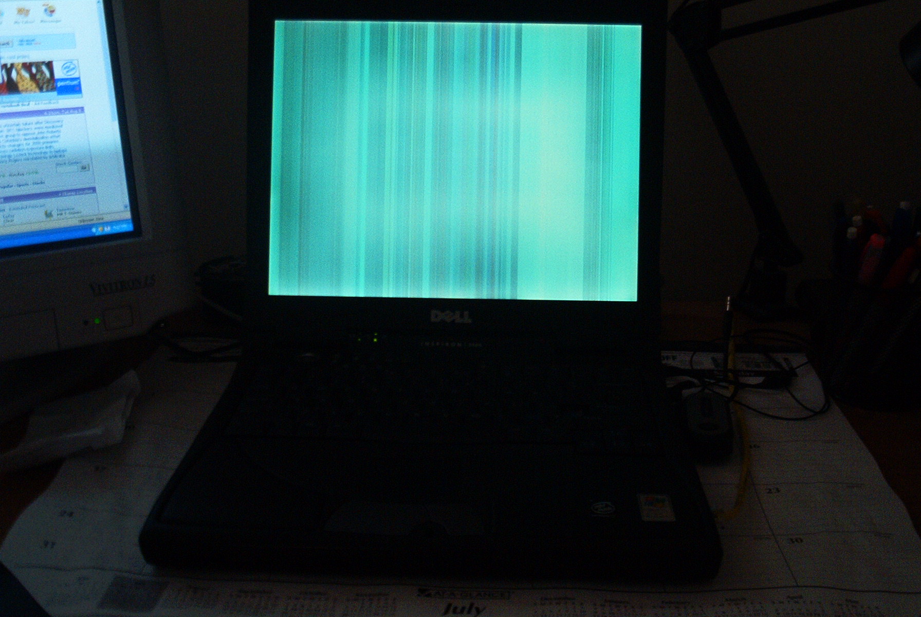

Has anyone repaired a laptop screen? I have a dell 2500. Below is a pic of my problem. Been like this for about a month. I have it plugged into a monitor now.

I would say that the connection from the video driver to the screen went bad if it works fine when hooked up to another monitor. My Dell latitude screen started going all kinds of funky colors and Dell replaced it under the warranty. They came out to my work and did it. Was interesting to see how they did it. Mostly the screen cost more than the laptop now a days.

Yea it works with a monitor hooked up.

Ryan, it's either the cable itself, or the connection on either end. Those screens aren't terribly hard to take apart, if you know what you're doing.

I cannot believe it but the screen is working for a second day in a row. I didnt plan on getting rid of it we will probably need 2 computers here.
They make this stuff called ProGold. It's a contact cleaner and it works great. I've used it to fix a lot of intermittant low current connections.
I think you can get it at RadShack now.
If you can pull the display apart and find any connectors, unplug them, spray them, and reconnect them. Since yours comes and goes, it's probably a broken wire (unlikely) or a bad connection (most likely).

I dunno guys. If it works with a monitor hooked up, I'm gonna go out on a limb and say the display is toast. Laptops (I'm pretty sure) use teh same video card to drive both the external VGA input and the display inside the computer. I'd call Dell and tell em you want a new one.
I'd definatly be interested to hear what the cause of this problem is. We use laptops at work a lot and I've seen a few displays kick the bucket.
It's the display itself or the cable between the system and the display. I've seen those cables go bad, and have a drawer full of good ones in my cube should I need one.
Yes, the LCD and external display use the same card, but you can enable them for dual-monitor with seperate outputs on some models. We have some that you can use as dual-monitor and the 2 displays will have 2 distinct desktops...
I think a display is like a GM ignition control module. Once it quits, it don't ever come back if all the connections are good. I've only replaced about 3 or 4 dead ones in my lifetime, so they are rare.
If it comes and goes, it's most likely a bad connection or cracked trace somewhere. I've seen bad solder joints cause this also. If everything else looks fine, heat up each pin on the connector with a pencil tip soldering iron, using just a little bit of new rosin core solder to touch up each one. I fixed my buddy's TV last week doing just this. Something was intermittant and I must have wiggled everything in the TV at least once trying to find it. I resoldered about 50 connections and one of 'em must have been it! It has been working perfect ever since...
If it works some of the time, it can be fixed. It just takes a little time and patience. Good Luck fixing yours! I hope you're successful!
