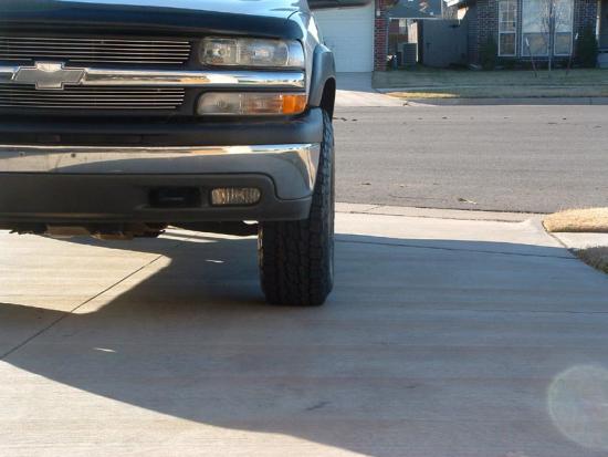

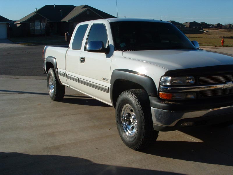

285s on my 1500 Z71
No rubbing whatsoever

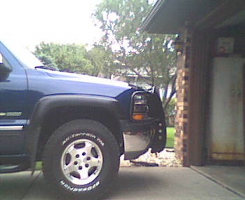

285s on the '02 in my sig. I'll put up some other pics if you need them. :driving:

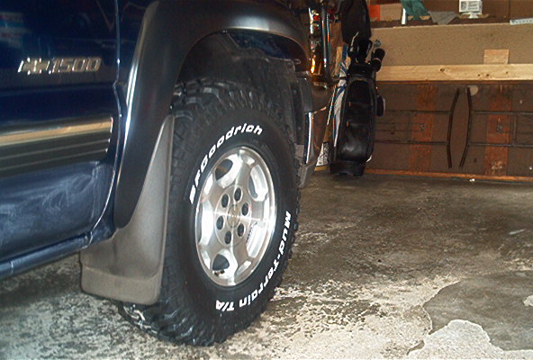

Keep in mind that I had some rubbing issues because of the offset of the aftermarket wheels, even with the torsion bars cranked a bit. I had to trim an inch or so off of the airdam. The same tires on stock rims never rubbed a bit.
The first and second are from the day I got the wheels and tires. The third pic is with the same size/brand/model of tire, but with stock rims.
