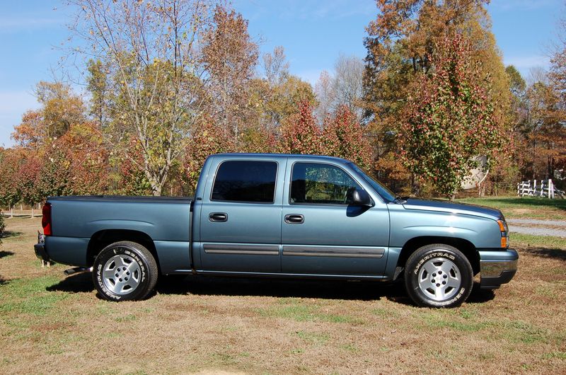

Hi i have an 06 crewcab shortbed 2wd with the 5.3.....So far i have S&B Cold air, throttle body spacer, custom tune, shorty headers, corsa exhaust...oh and the 160 tstat. Power pulleys i know....dont have any yet...anybody got any suggestions on good pulleys? Also what next guys? What should i do now gotta get more ummphhh outta it..
CAM?????? dont know much about cams....i have a good mechanic that will install it pretty cheap..i assume i would need a retune after the cam?
any help would be great

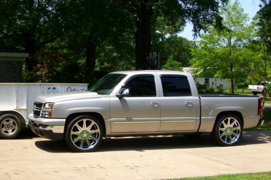

Can you email me some info on your truck like wheel size and how much is it lowered.
jamadm01 @ Charter.net take the spaces out....
