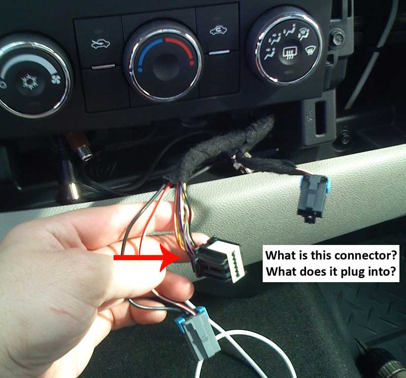

Anyone know what this connector plugs into? Does this have anything to do with dual zone hvac controls? Any input is greatly appreciated.

They could be connectors for adjustable pedals, rear parking assist, or stabilitrack. I know in that area on my truck those are were the buttons are.
Thanks! That was what I was looking for. I wonder if the standard trucks are equiped with those features but just dont have the buttons...

Backwardthreads is right The plug is for stabilitrack,adj.pedals,park assist,heated washer fluid.
as far as just getting the buttons to make the features work...No, They just have the wires there so that they dont have to manufacture so many different harnesses.
