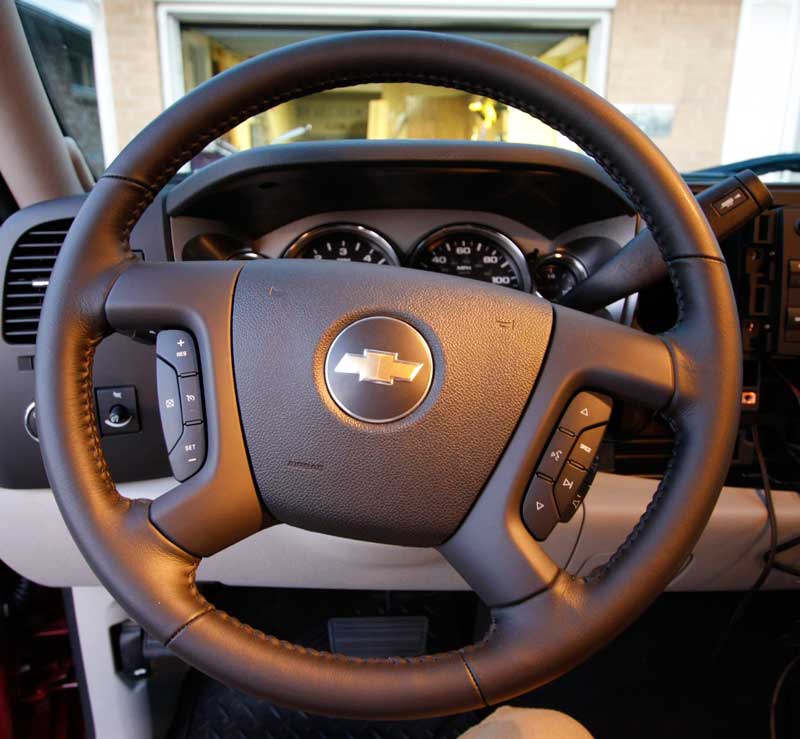

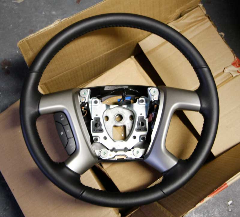

I went out on a limb and purchased a steering wheel with the radio controls on it and installed it tonight... it worked without any reprogramming of the PCM (like required on earlier model Silverados). It installed in about 30 minutes (since I had a hell of a time finding a small enough screw driver to help pop out the yellow connectors locking the airbag connectors in place).
I ordered part number 15917931 (black/black) steering wheel to replace my (black/silver) steering wheel. It says Ebony on the parts sites. I think black looks better than the silver and the black finished is a rubbery-plastic material instead of hard painted plastic... much nicer feel.
Anyway, if you dont know how to take off the steering wheel, read up here: http://www.autowoods.com/installation_guide.htm
it is pretty much the same procedure (easier actually). Just remember to pull the yellow tabs out before trying to disconnect the airbag connectors (and I am not responsible if you set your airbag off :rolleyes: ).
In the end, all you will need is the steering wheel (part number 15917931) and a steering wheel puller with the GM Puller legs. Total cost is approx $210 shipped for everything.
I then spent the next hour trying to get that damned PAC SWI-PS to program properly for my nav system... but finally got that working properly too... now I am extremely happy with the truck. I had really missed the steering wheel controls from my previous vehicle. Take a look at the original steering wheel picture and the new steering wheel installed picture.

The airbag just snaps into place, very easy to do. You just push it in until you hear it click into place. The connectors are the same the in the old wheel with cruise control and the new one with cruise and stereo controls. The only difference between the wheels is that there are audio controls and an extra wire coming off the main connection going into the audio controls... but the main connector is the same type/size.
