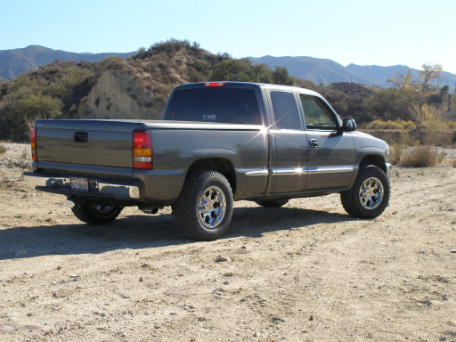

The rough country 3" spindle kit is a straight forward kit to install and the truck sits level . So far so good, I have had the lift on for about 2000mi. I dont really like the shocks though. Later I will probobly go with some KYB's or Billstein. I was inquiring on the coil spacers because I like the "pre runner look" and I wanted 285's on new wheels. I couldnt wait to see if the bigger tires would work so yesterday I went and got wheels n tires! 265 70 17 BFG AT on motometal chrome 955's. I had to trim the front plastics so I dont think 285's would fit. Pics soon!

You know of course....your gonna have to post pics now.
