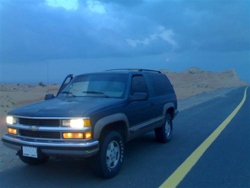

what do you think the reason of oil pump failure???? yes, I do put pressure on the engine when off-roading .. but does this mean new GM engines cant stand the pressure? I used to have '95 2dr tahoe 5.7 carbo 120k miles & NEVER said no when I floored the pedal

Nice, I love those older two-door Tahoe's. BTW, it's not carbureted, it has throttle body fuel injection. Pull the air cleaner lid and you'll see two down-firing injectors above the butterfly valves.

no s**t! :tumbleweed: shame on me
