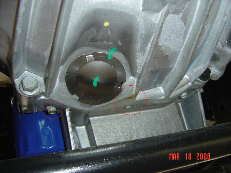

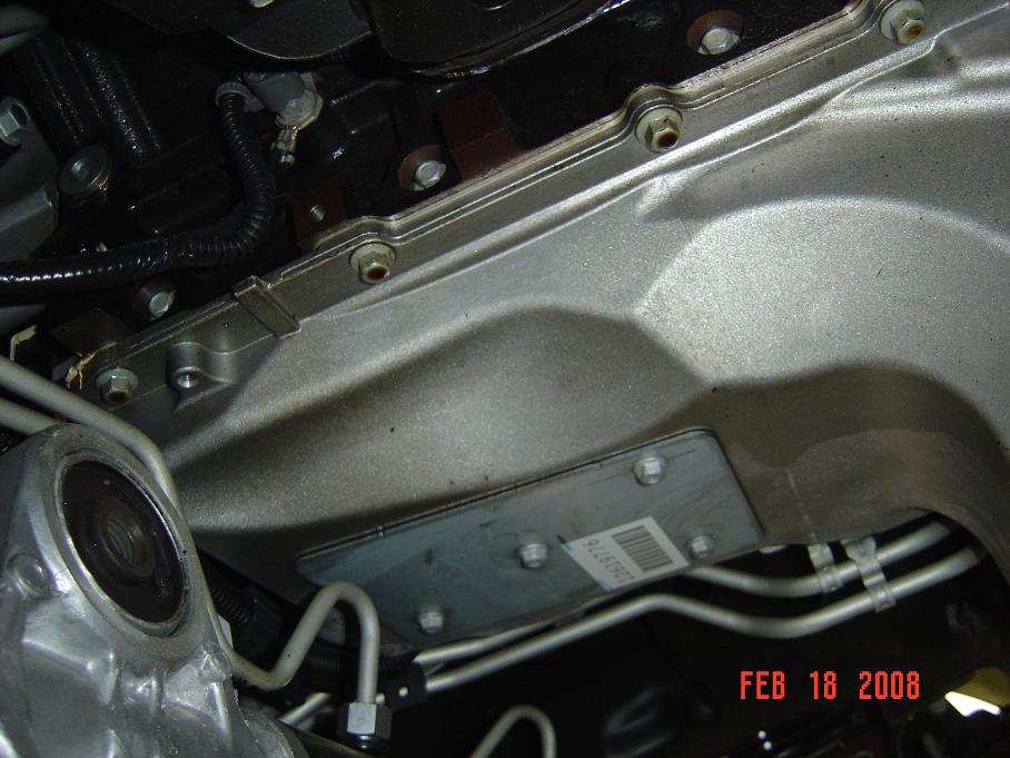

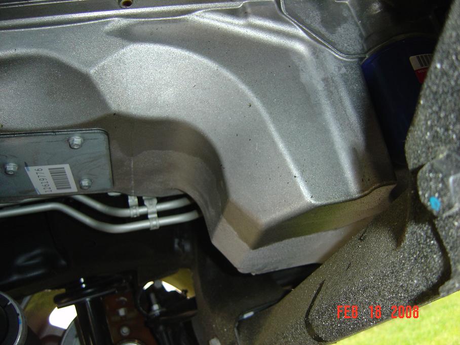

2008 Avalanche w/ 5.3L & 1300 miles, so far. I want to do an oil change soon and was looking around under the truck. My oil pan looks wet but doesn't look like its leaking anywhere. So, I used a paper towel and tried to warp it. It doesn't warp off and the paper towel did pickup a very slight trace of oil. Have anyone else seen this before? PICs attached..
Well, I finally did my first oil change today at 1400 miles. Sure even, I have an oil leak. Its not enough to drip yet. But, the oil pan is wet and 4 of the oil pan bolts on the driver side have oil on it. On top of that, the oil filter was so tight. It felt like the filter tread was stripped. The filter started to collapse and I had to loosen at least 1 full turn with my oil wrench before I can turn it by hand. I have always had and bought new GM vehicles. This is very discouraging.

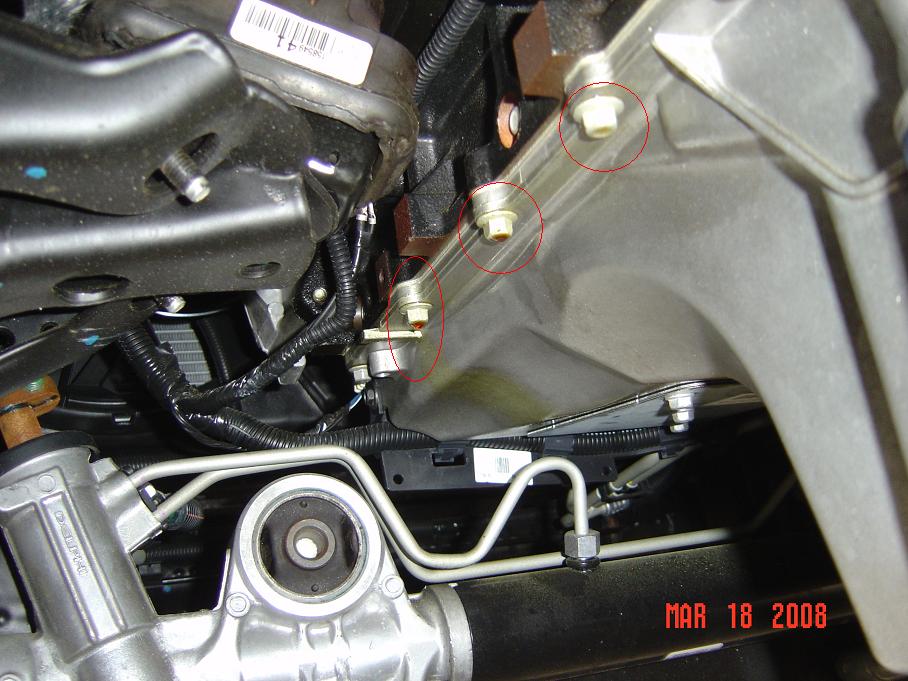

More PICs on leaks.

Some update.. Well, the truck is at the dealer now. The service advisor just called and said its leaking from the oil pan bolts and the rear main seal is dry. So, they are going to put some lock tight on the bolts. Then, he said those trucks use RTVs and no oil pan gasket. ??? Anyway, I told him they do have a oil pan gasket. In a way, I am glad they didn't take off the oil pan. I just don't have much confidence in them. Hopefully, the leak will stop. If not, I am taking it somewhere else.

I was about to say...there's oil all over your bolt heads...
