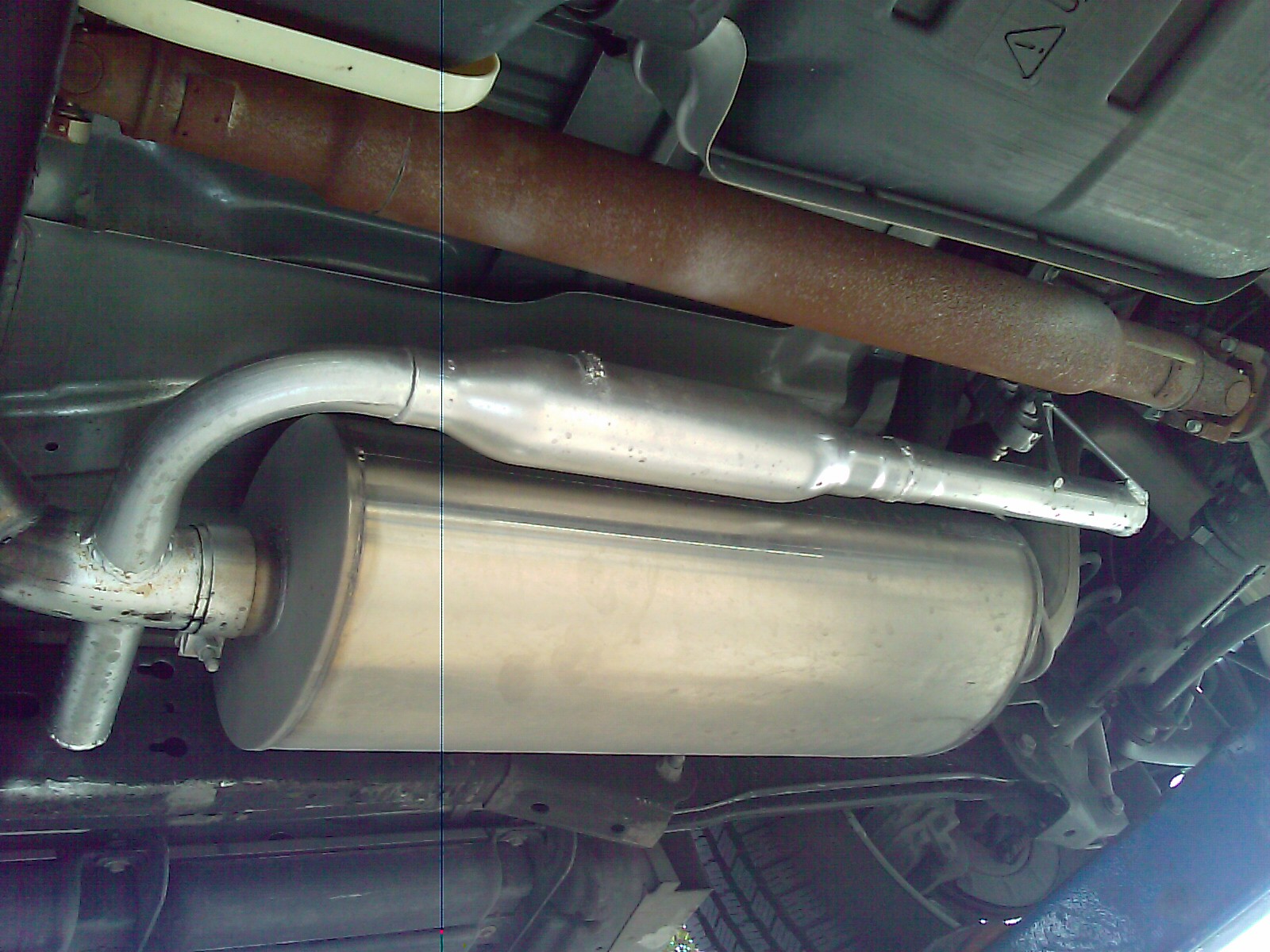

I've been messing around with my Corsa Sport exhaust to quiet it down a bit and help get rid of some drone around 2k RPM. There isn't a whole lot of room for a resonator, so we put one towards the side as you can see in the pic below (took with phone).
It's rather small and I think it came from a Chrysler, so it doesn't make a huge difference. But it does cut back the volume by about 2-3db or so at WOT. It also smooths out the exhaust tone and reduces some of that high-pitch raspiness. I like it.

The Corsa sport is way quieter than even the longest Magnaflow (22"). But if you're rather picky about drone, go with the Touring.
