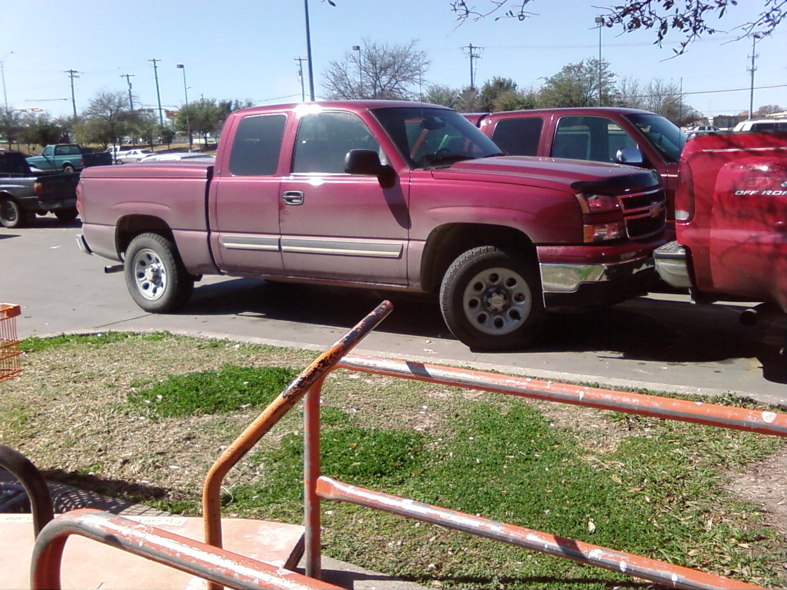

Here is what an extended cab looks like with a 5'8" bed (Stupid if you ask me):
sorry for the crappy pics, I took them with my camera phone in home depot
:lol::thumbs: That is the most retarded thing I have ever seen...
Actually some of them don't look too bad,It depends on the color and stance of the truck. A Black or Red Z71 with the Aluminum wheels (Not the chrome steelies) that sets nice & level looks pretty sharp in that combo.
Now I personally wouldn't buy one,I need the bed space that the 6'6" bed gives me,but some look OK.
