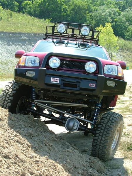

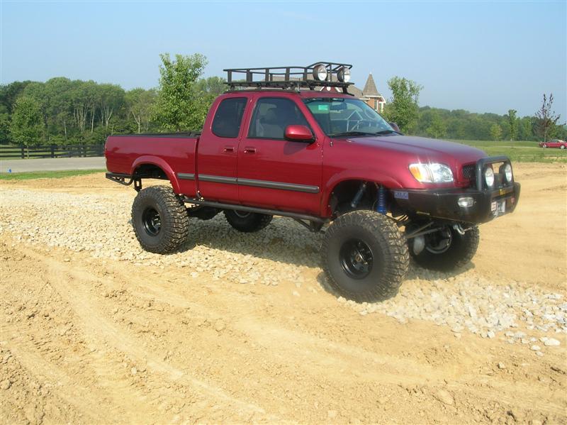

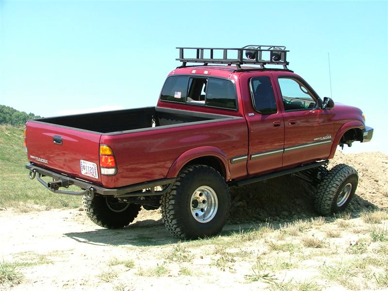

Glad you got it alllll figured out. Got any pics of that 01 Tundra?
Here's a couple...
Here's a couple...
Now you know why I can't stand the low rider look!
Yes, now I do. That Tundra is SWEEEET!!!
