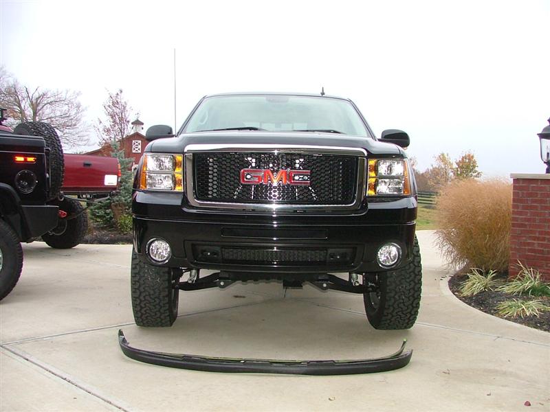

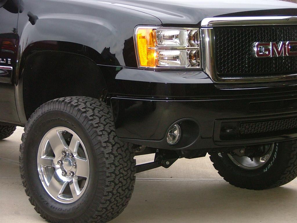

First, the truck looks good!
Second, I started this thread back in 08 when I first lifted my Denali, I can't believe it is still active!
Everyone: You can easily lift a Denali with AWD. All you need to do (which none of the suspension companies) (I think) is to take your stock front driveshaft down to your friendly drive shaft shop (Local) Tell them to put a double cardan joint on the transfer case side and reinstall. Voila! You're done, drive forth and do good things.
Oh, and if you trim up that spoiler thing and black out at least the lower grill it will get that smiley face thing off the front!
