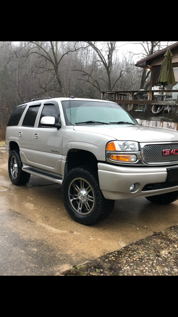

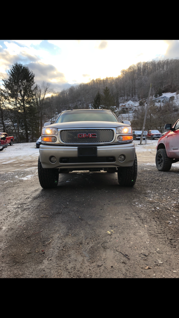

i have a 2005 Yukon Denali awd lifted with the rough country 6 inch lift,
i have a small vibration when  coasting with out a strain on drivetrain in front shaft only( actually not much vibration, just a vibration noise more than feeling it)    , i am going to get the double joint shaft and that  should eliminate this issue,
the stabil-trak light is on at moment, but i am going to reinstall the factory front shocks with extension to see how it handles and rides,
at the moment, the yukon drives and rides almost identical to before lifted,  i have 35-12.50-20 tires and rims
front rims are a positive 18mm offset 20x9
rears are 0 offset  20x9
the wheels set just outside the fenders , clearance is great , had to trim a little on the front bumper on bottom, and just a little off the
rear inner fender where the denali has the extended running boards and flare  ( where it extends into the inner fender well on the rear of the front end ,  you cannot tell where i have cut this area due to it was on the inside of the fender well,
