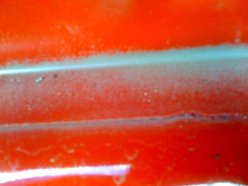

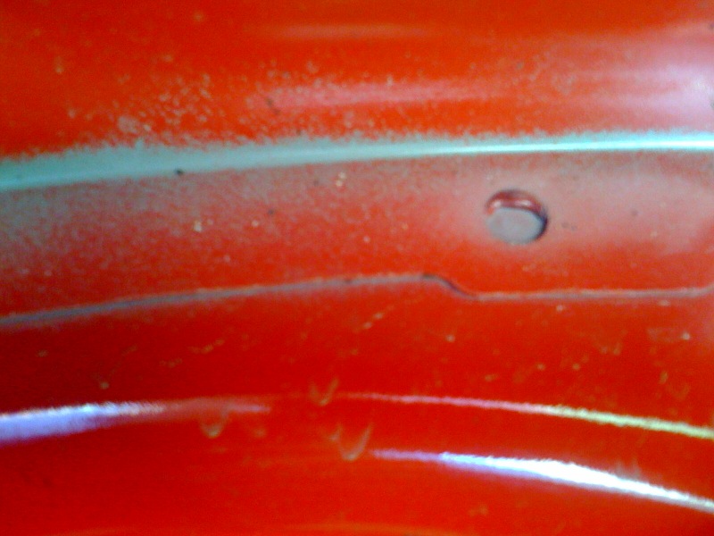

Anyone else missing paint on the bottom side of the back fender wells where the bed skin and the wheel tub come togather?
Mine just looks like they missed painting the body seam. Went to the dealer and I have go to their body shop on Monday to see if it will be covered. You might want to check your fender wells on the 07's and make sure they are fully painted.

My black '07 is the same way in the wheelwells. It is also missing paint behind the hinges on the extended cab doors. They offered to paint it but I am way to picky. After being a body man for 4 years I notice all of the differences in the paint from factory to the new paint job. They would have to break it all down and repaint the whole thing to blend in. But it is just in the door jambs and so far I am the only one who notices.

backardsthread - I do agree with you about working on the factory paint, but this is just under the wheel wells, so blending etc should not be an issue as long as it is close. It will hopefully always be in shadow anyway.

The wheel wells don't really bother me, it is the door jambs that bother me the most. I went to there body man, which they contract out, and he told me he could fix it but man I don't like tape lines and the no paint issue is actually on the door edge as well. I really don't like the idea of repainting a truck that is brand new.
