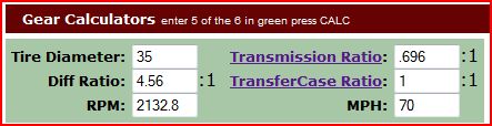

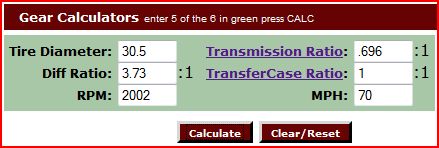

3.73s and stock tires is a very similar final drive ratio to:
4.10s with 33s
4.56s with 35s.
4.88s with 37s.
Here's a gear/tire size calculator:
http://www.4lo.com/calc/gearratio.htm#ratios
And I did a few:
Stock (245/75R16)
35s and 4.10s
35s and 4.56s
EDIT: With the extra weight of the 35s, a slightly lower gear will help get the big tires moving easier, and will put less strain on the transmission.
EDIT2: This is where you're at right now, with 35s and 3.73s, so the 4.10s aren't that big of a difference, and might not be very noticeable on takeoff.
