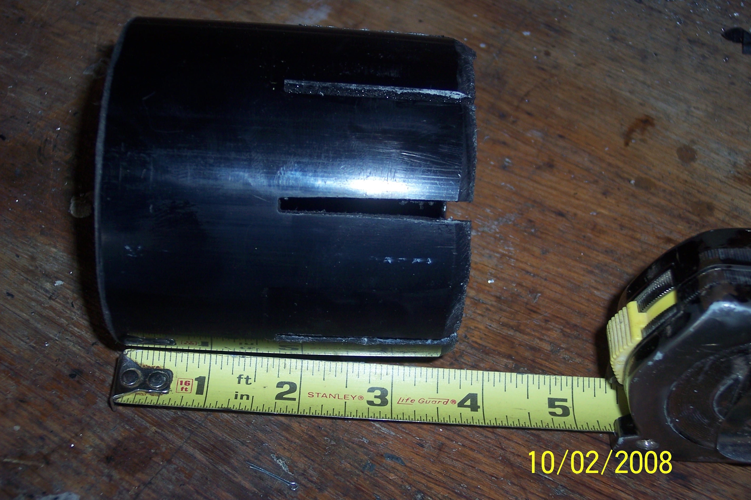

I have a continuing problem with the cup holders in the console of my Z71 '01 Chevy. If I put a bottle of water in the holder and turn a corner the bottle trips over and sometimes falls on the floor. I have taken out the rubber fingers and turned them over with no gain. Then it hit me to make a cup holder that is taller.
By taking out the front cup holder assembly I started by measuring the diameter of each holder. The top measured 3.5". The holder is tapered slightly so I knew that I would have to taper my new improved cup holder. I purchased 1 foot of ABS pipe in 3" with an OD of 3.5". To make the taper I made a series of saw cuts(4 passes to make 8 cuts) in one end with my table saw. This allowed the pipe to squeeze together to fit the taper. Next I cut the length 2" above the top of the original cup holder. Using some coarse sand paper and a belt sander I sanded the upper and lower edges to relieve the sharp edges. I used some Goof Off to remove the printing ink from the pipe. Finally I pushed the pipe into the cup holder with the rubber fingers still in place. Very nice tight fit and the bottles and cans can't tip anymore! :thumbs::D

For those of you who lack imagination I will attempt to post a pix with this reply. Here are the measurements I used:
Total length about 4"
Slot length about 1.75"

My cup holders are for the center console. But if your holders are 3.5" it will work. If a different size go to the local hardware store and measure various pipes and get one that's right.
