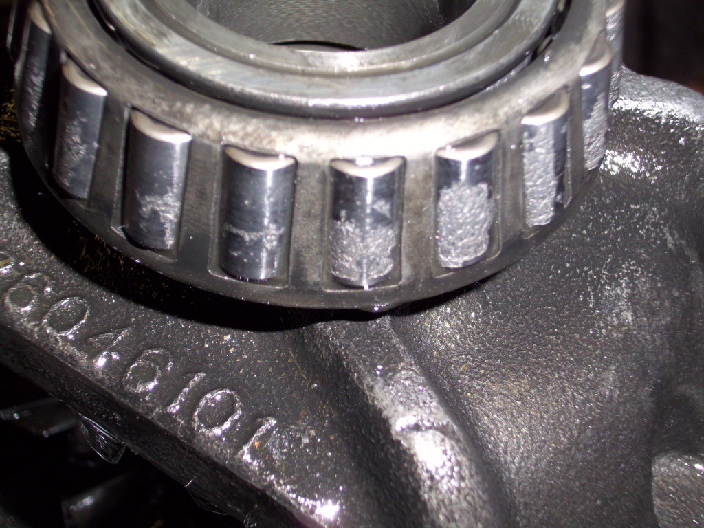

just got off the phone with my friend who owns the shop i go to. he said he's replaced two front diff's on '02-'06 Escalades due to a similar noise. was the bearing on the driver's side axle of the front diff. it ended up being cheaper to buy a reman unit and have that installed due to the factory one more times than not will not relinquish control over the driver's side axle. usually seizes up in there. what it was on the two he's done, both this year was the driver's side axle bearing on the inside of the flange where the cv joint connects to it. he said both customers had hub bearings replaced before going to him.
cost for the transplant with the reman unit was approximately $1,400 ($1,000 unit & $400 labor/misc). hope it's not this, but just trying to help..
oh btw he said if you get under there and push up on the flange you should feel excessive play if that's what it is, says it will move indicating a bad bearing on that assembly. good luck.
the 03-04 SS are known for bad carrier bearings. mine went bad with only 190 mi new. a lot of the issues were bad bearings from a suppler, and a retaining clip that can come louse..drain your front diff and see how much metal is in there. as long as the case is not damaged, coat can be over $1200 parts and labor depending on who dose the work. if the housing is damaged, GM no longer stocks them, haven't in a lot of years. if it is expect top $$$ for repair..

if you need a price or where my friend got those reman units i can ask him. i think this pic may be the same part i was told. is that bearing on the driver's side of the carrier or is it both that go? maybe that's why the noise is primarily on the front left due to the offset of the carrier?

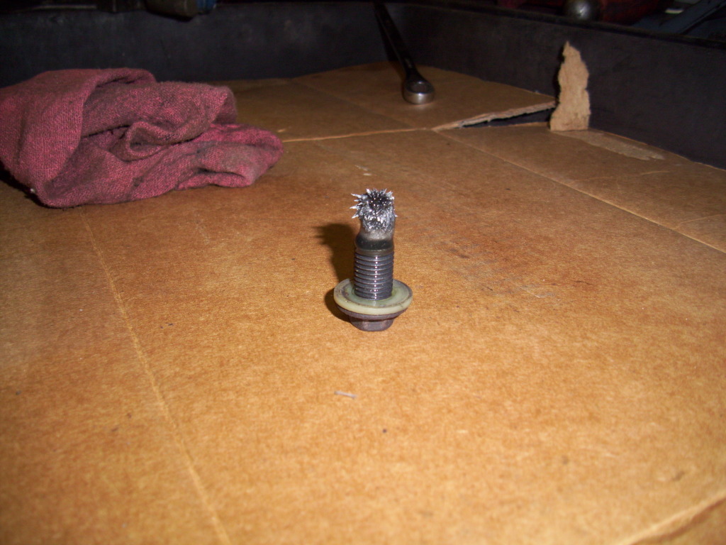

I don't have the full time AWD system but the OP's condition sure sounds similar to mine. I also had quite a "puff" of metal shavings on the diff drain plug.
