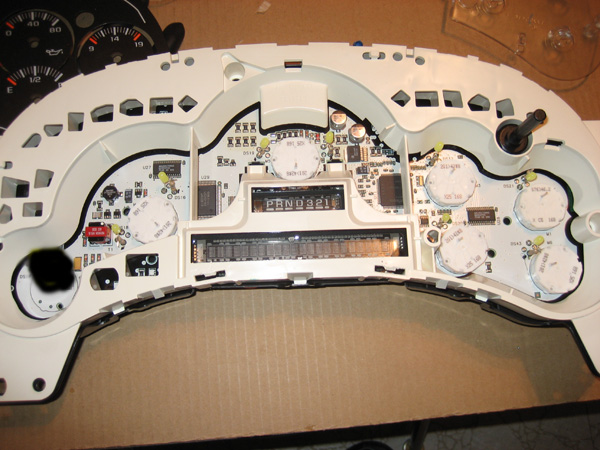

Using my soldering iron I just hit them for a few seconds right next to the little blue cradles that hold the bulbs. There are four solder spots for each bulb but only two are holding the bulbs in. Once you get each corner they pop right off.
Once the bulb where removed I wanted to be sure which of the connections were my positive 12v and negative ground. So plugged just the circuit board back in (blue clip on harness facing down) and using a 12v test light I just checked each bulb location for my positive 12 volts and put a small dot next to it with my Sharpie.
I cut each resister down on one end and soldered that straight up to the positive connection for each bulb. Then I bent each of the bulb leads to fit properly next to the resistor while keeping them as low as possible. Remember LEDs are polarity sensitive. So it is important that they are installed on the correct positive and negative terminals for them to work.
Notice resistors and sharpie marks
Bent leds
Notice Positve and Negative
Once they are all soldered in I put the white plastic piece on top to be sure they weren’t too tall.
To test them I soldered some wire onto the terminals where the bulb for the trans temp would go (I don’t have a trans temp gauge) and hooked up a 9v battery to it. And to my surprise they lit right up.
Then I took it out to my truck just to double check and made sure they still worked properly. They are even dimmable.

Here is a night pic of the the dash.
The light is very even and no hot spots.
I am really impressed on how it looks. It is almost a blue light, it kind of clashes with the rest of the lights. I guess I'll have to work on the radio and the HVAC next.
