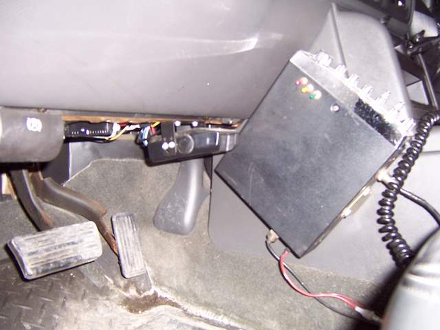

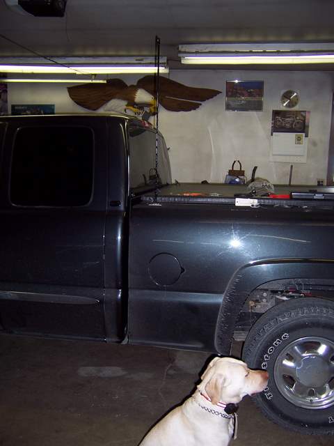

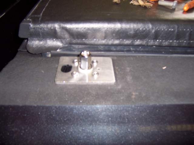

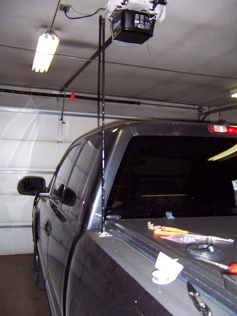

Well i found this mount that uses a stake pocket to mount your antenna and i figured how often do i use that stake pocket anyway so i installed it and here are some of the picture from the install.
What type of CB is that. I've been looking to add one to my chevy but my antennas will probably be mounted to the tow mirrors.

I would mount mine in the rear stake hole since mine is a crew cab and the cab may generate interference...did you check your SWR?
I didn't know anyone was still using CB's.
Yep, even with cell phones we still use them, I mostly use it when I'm on the high way for long stretches, it good to know where the next speed trap is or whats going on 5 or 6 miles down the road.
Yep, it's at the bottom of the scale on 1 and just under 2 on 40
nice, I had mine in the rear passenger stake hole because my SWR was high on 1 and 2. That is until someone stole the CB radio (kinda wish they had taken the OEM radio as well).
