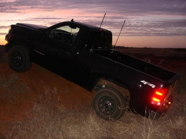

How did you mount your antennas? From your pic, it looks like they are in the forward stake holes in the bed, right??
wow that looks really good man!! i have the same CB and i have a single cab 08 sierra so i dont have a center console :)
Yeah that looks like what it is
