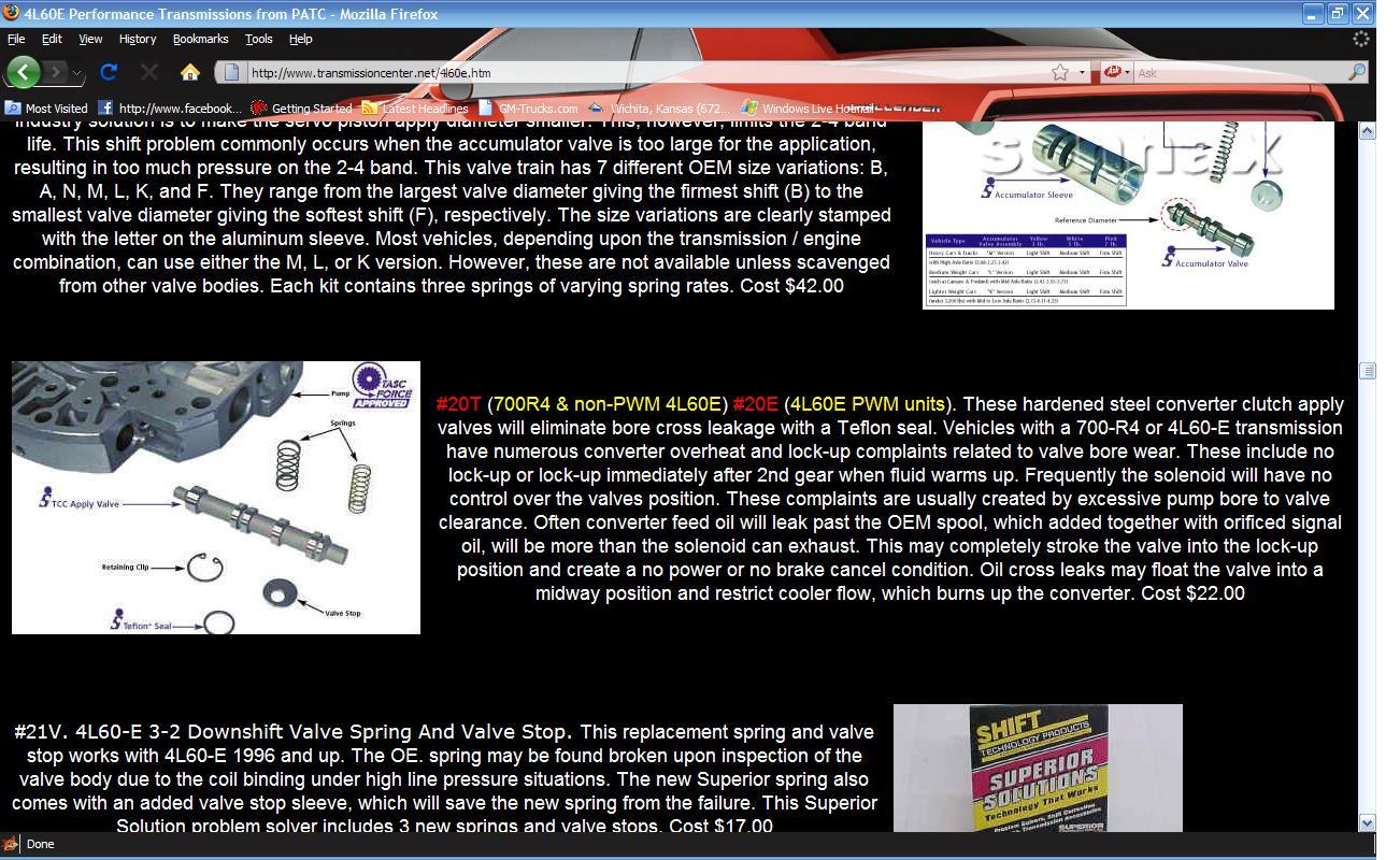

Possible underline causes for this ive found are, Bad TCC solenoid or wireing to it, bad TCC out of round bore in the VB, fried TCC clutch, or defective TCC clutch piston. Either way maybe replacing a valve body or torque converter.
http://www.transmissioncenter.net/4l60e.htm the screen shot is the part you may need, i screen shotted it because that tranny parts page is super long.
