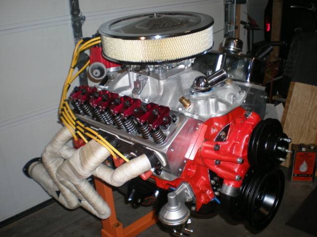

had an 79 silvy with this 383 in it and a 2800 stall wow it sucked for around town.
