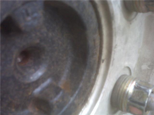

Heres a pic, anyhelp?
That pic looks like the wheel is fitting properly to me... but I won't stake my reputation on it.
