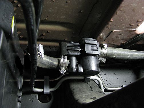

Pics of evap canister vent valve

It's location is in front of the gas tank, next to frame, where cab & bed come together.
I have replaced the evap solenoid and code went away on its own the next time i drove the truck. Part=$38
5/8" dia. heater hose 1 foot long and 2 hose clamps (around $5)
took about 10-15min to change
the valve should be in the pics,the filter is relocated ,I used to put them beside the master cyl,it worked good
