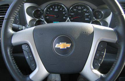

ok first time using a forum. ok i want to install steering wheel controls. cruise control and radio controls. now other then buying a new steering wheel with those controls on it, what else would i possibly need to get?
Easiest way? Find a steering wheel on Ebay or at a salvage yard that has all of the controls on it. Once you install the new wheel, everything should work. You could probably buy all the parts new separately, but the additional cost and assembly would be a pain IMO.
Use the search function in the upper right corner. There are instructions on here somewhere or at least a link to the instructions to add the controls to your steering wheel.
Short answer you cant buy the audio harness seperate.. I went the easy way. new wheel with the audio and cruise controls switches all at once. Cost me about $190. and 35 minutes and 20 of those was fumbling around getting the airbag off. I finally worked it out by using an allen key on the wheel without the airbag to work out the angle. Also
