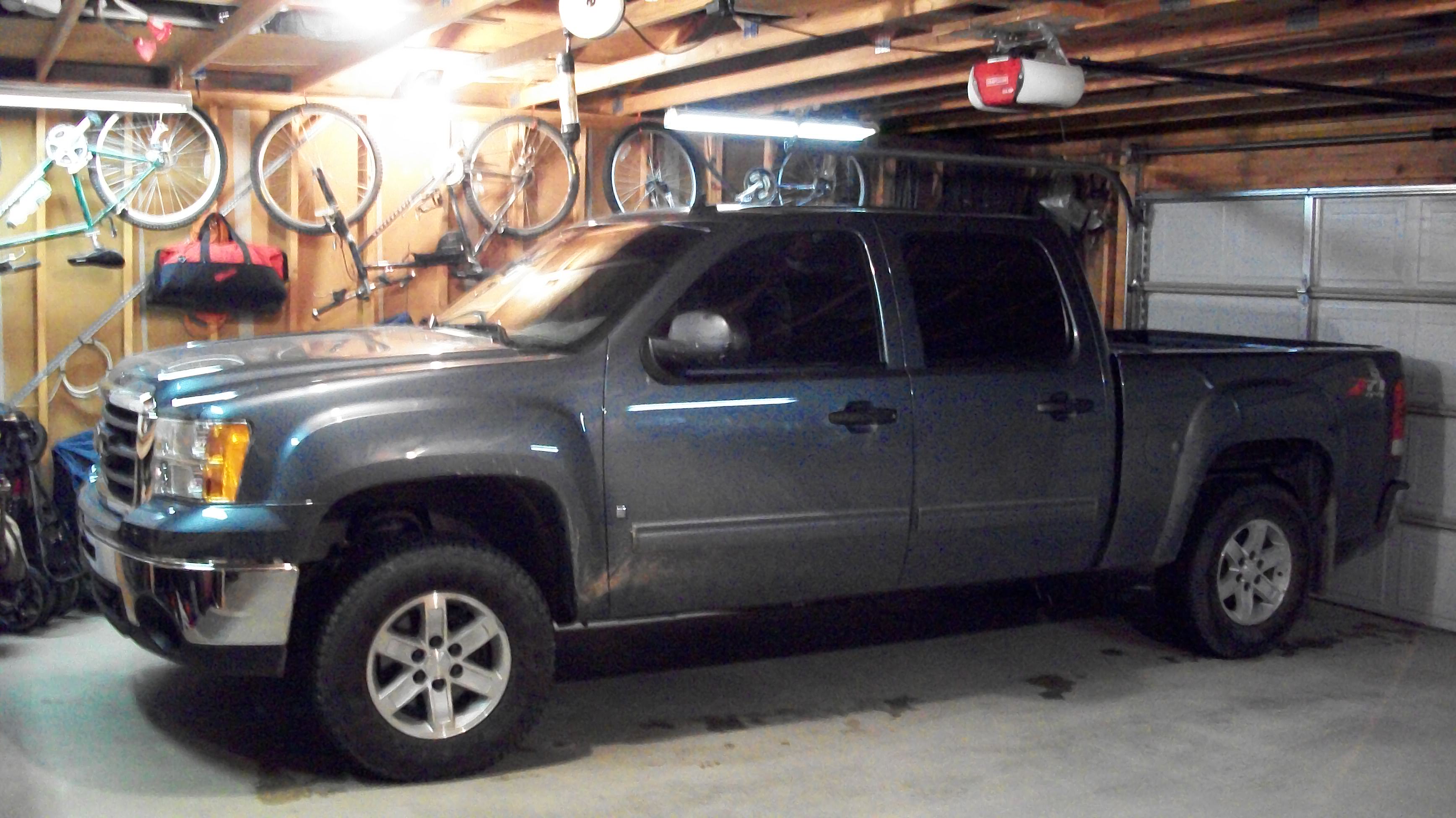

I finally took some pics of my truck to bad it isn't clean in these pics. The pics I took are too big to upload apparently. I installed the TopGun 2" kit a week or so ago. I just got the add-a-leaf for the rear, and a Magnaflow muffler in today. I hope to install the leafs after work tomorrow. Hopefully the muffler will be installed Sat morning.
Nice... I wish my garage was big enough to fit the truck... :uhoh:

Nice truck. I park my truck the same way in a garage, all the way back, when the door closes I have about 2".

I noticed you have the bilstien shocks up front ,, is this a better set up than the leveling kit .. why did you go this way .. thanks

You'll probably get opinions either way. I read up on them a little on the forum, and read some info on Bilstein's site that seems to say they're a little better than the leveling kits. What's nice is that you can set them for different levels of lift (roughly 0.6", 1.2", or 1.75") when you install them. I think one of the big benefits that I liked was that you can go with one of the lower settings to still get some lift while hopefully slowing any premature wear that a full 2" leveling kit would cause, which is why I went with the 1.2" setting. Another benefit is you get improved shocks over the stock ones and I think the front end now feels a little more composed over bumps than before. They are pricier than leveling kits (my cost was $210 shipped), but I think it was worth it.
