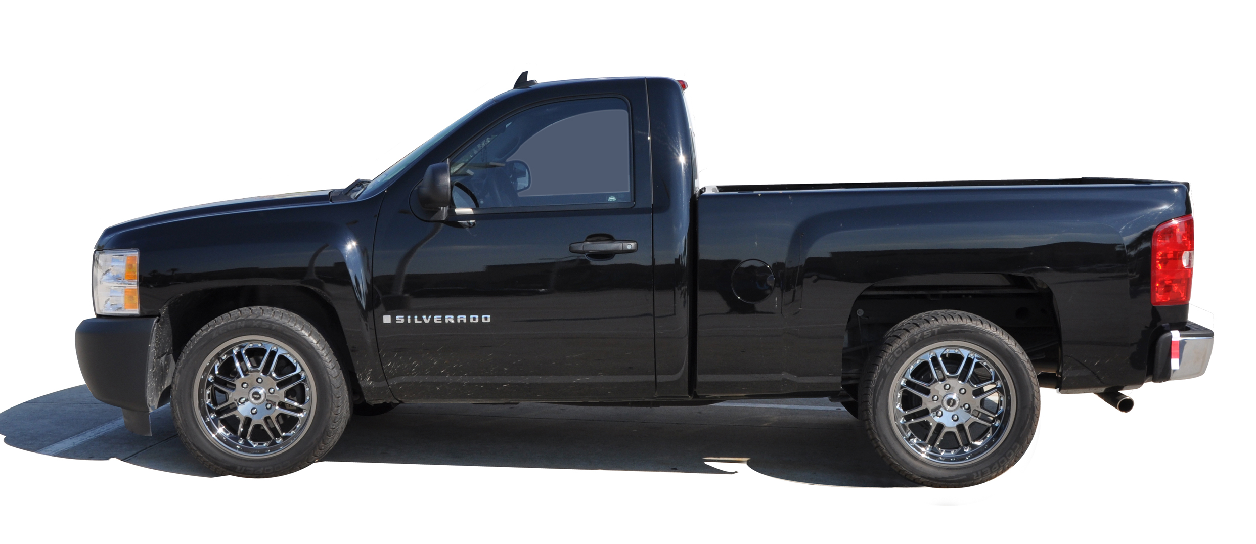

Hi guys was wondering if any1 has had this happen. On saturday i got my Black Bear tune, and on monday on my way back to work the CEL came on. It was on prior to tune, because I installed longtube headers a couple weeks before tune. I taught the tune was suppose to take care of the CEL. The light was off after tune but came back on. Let me know what you guys think.
2008 silverado 4.8 RCSB mods: GMPP CAI, Long tubes, Magnaflow exhaust, and BB tune.
