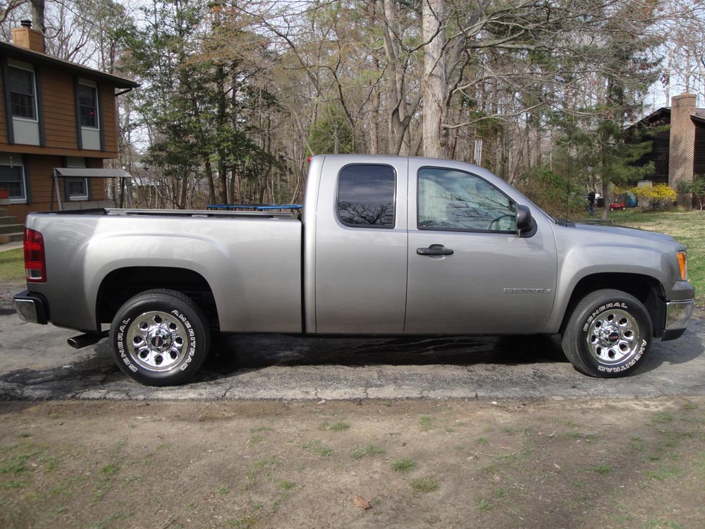

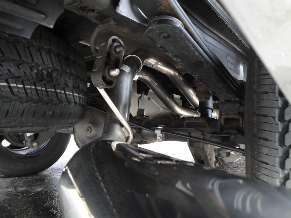

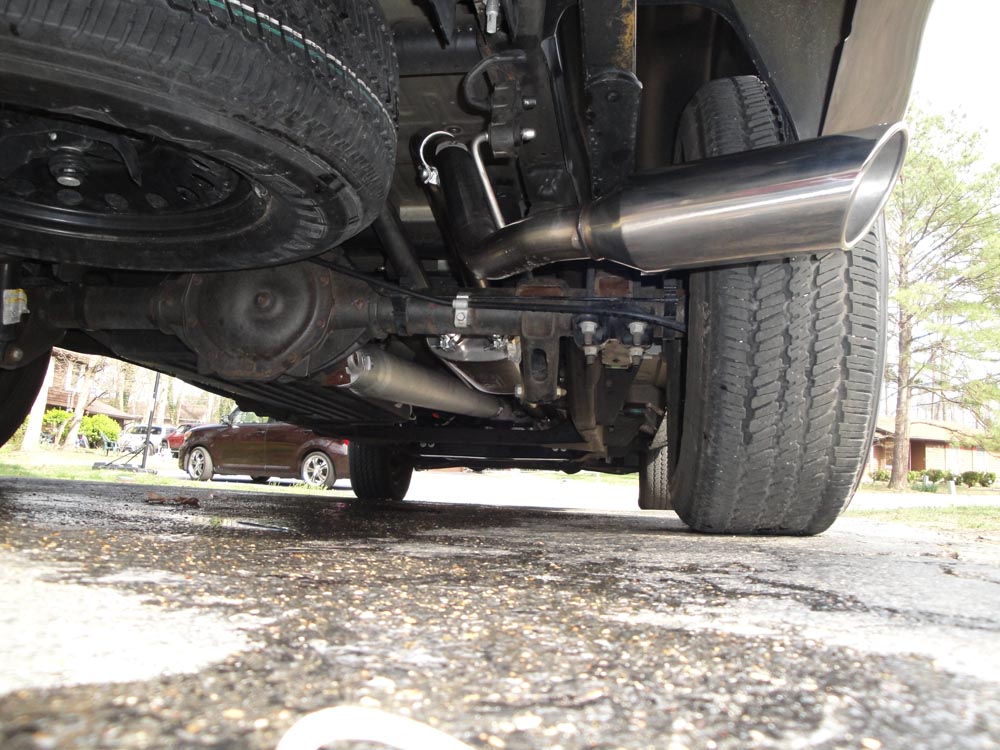

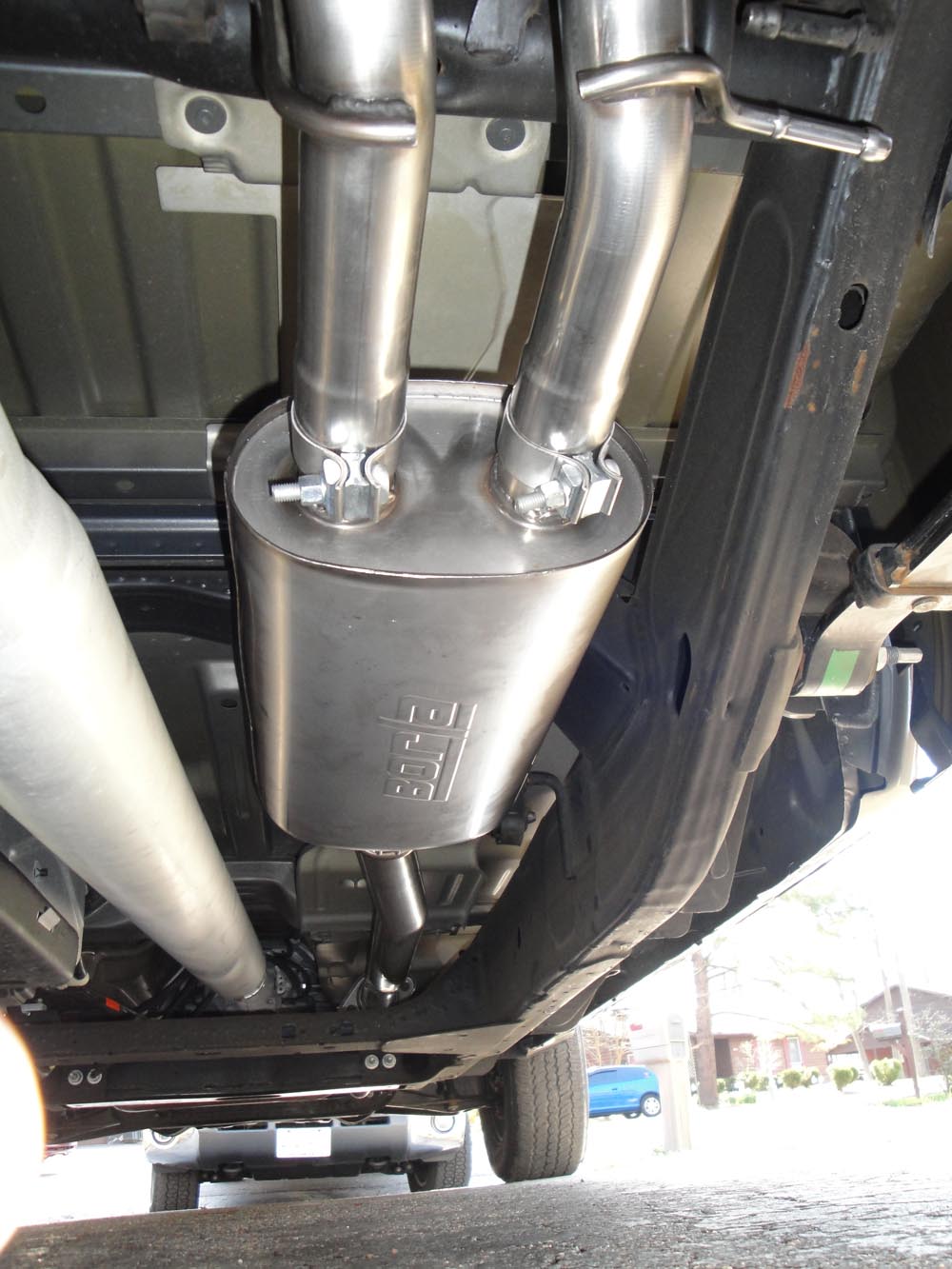

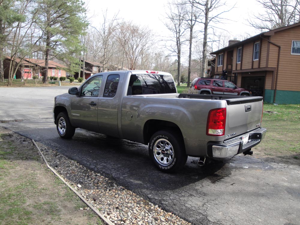

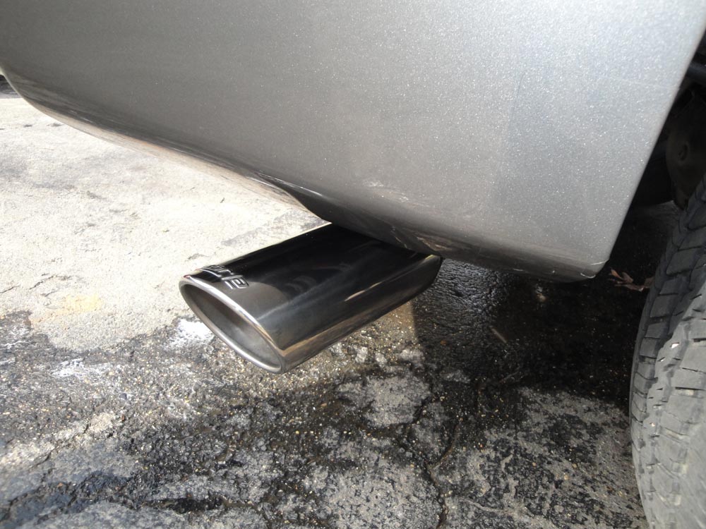

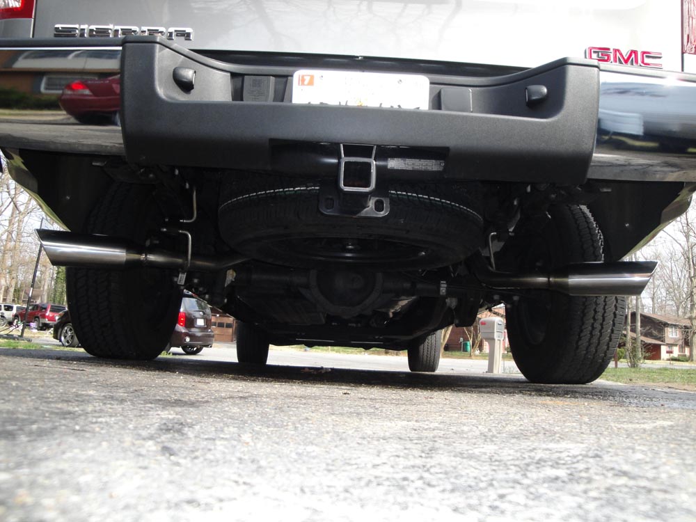

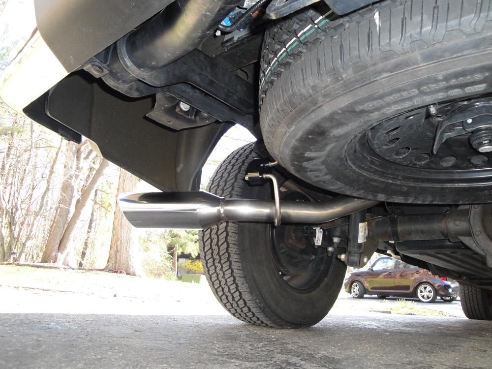

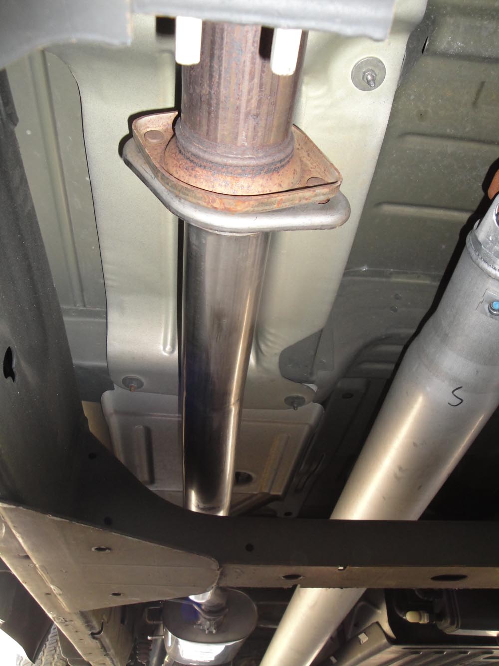

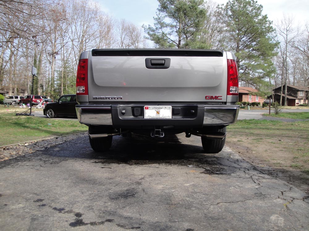

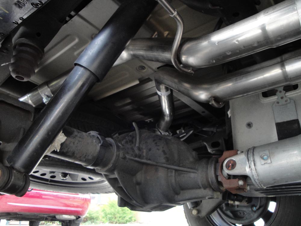

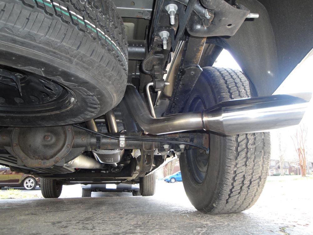

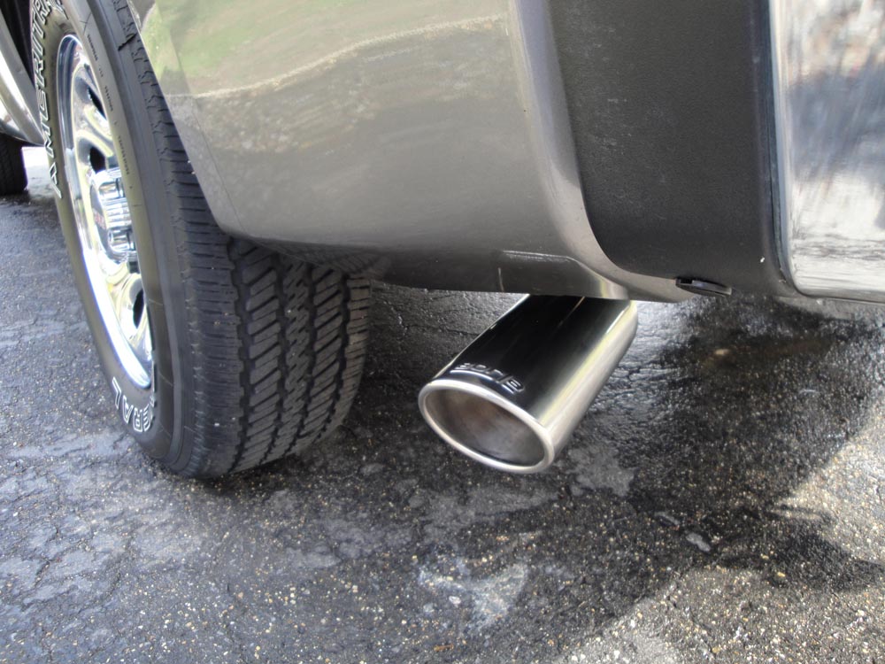

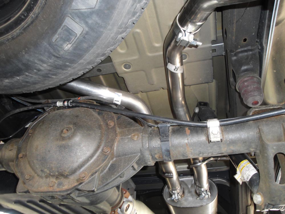

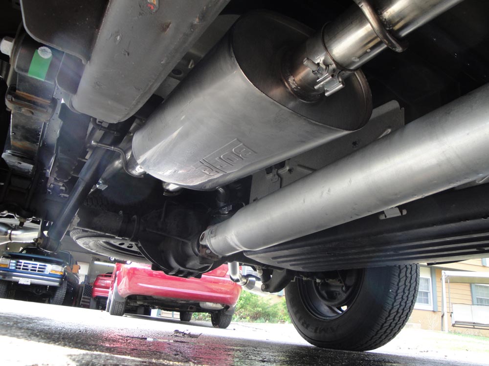

Here are some pictures of my Borla 140232 exhaust system. I need to align the tail pipes but I'm waiting until I get my rubber hangar. My truck didn't have two behind the muffler and the Borla system requires two.

It's quiet, which is what I wanted. It gets loud around 3rd gear and at 2,000 RPM's. My wife doesn't mind it at all, that's a plus. Very easy to install, but if anybody orders this system make sure to check if you have two hangars behind your stock muffler. One hangar was bent and welded to the other and didn't have a rubber insulator. You can see in some of the pictures that there's a missing insulator.
