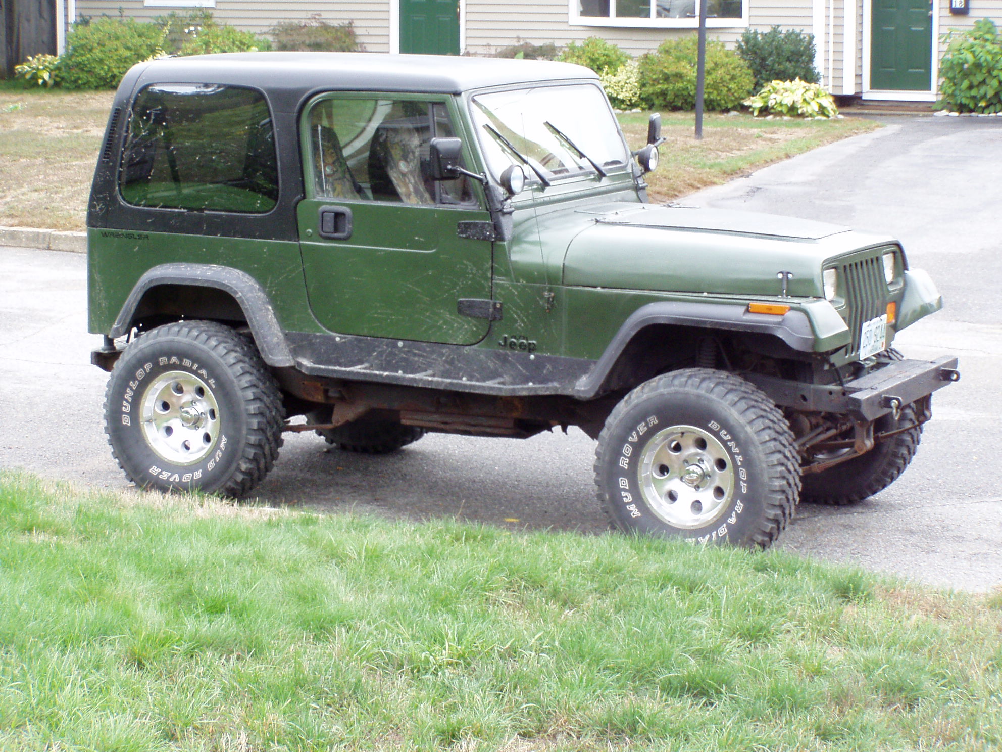

I used it on some homemade jeep steps and it started to peel off in a week. Could have been the fact that it was on a :uhoh: JEEP.
Pic of steps on jeep included.
But really, i wasn't impressed with it.
