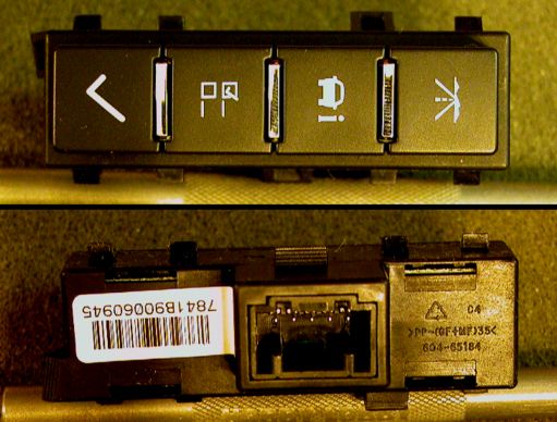

Here's the Driver Information Center control switch we have all come to know and love, fresh out da' package from one of our sponsors... OEM Parts Today.

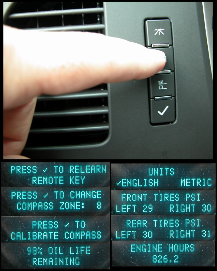

Here's what happens with the displays AFTER you install the switch.
Not ONLY are the pictures I show all that becomes available once this switch is installed. Several of the displays I show in the following pictures have more choices within them, but it would have taken quite a bit more time to show them all. Suffice it to say, this is a well worthwhile upgrade!
Here's the choices for a button #2 press. Again, there are options within each menu item in many cases. For instance, to reset the "Oil Life" is now a simple press of the 'check mark' button and the resetting of the TPMS is also just a press of a button instead of the old 'remote' way.

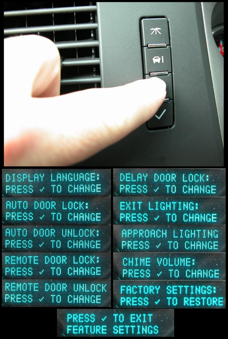

Ok, here's the final set of pictures for this upgrade.
This last button gives the most options and choices of all. Every selection here gives several choices within the selection and I understand there are even MORE options depending on installed equipment in the vehicle! I say "last button", but these pictures only take it down three. The last button is a "check mark"....."acknowledge" button used to acknowledge options and choices and to "reset" options and choices.
