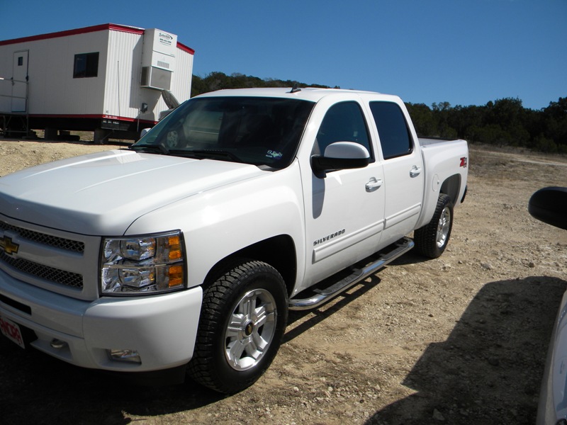

I have been lurking around here and reading a lot since I bought my 2010 CCSB Z71 4x4 at the end of February. I have already gotten my bed sprayed with Line-X and installed a tool box.
I love everything about the truck except for one thing though...the rake. I have been wanting to put a leveling kit on the truck since the day I bought it. I have done extensive searching on this site and others trying to figure out which leveling kit to put on, and I think I have finally decided on one. I am going to get a 1.5" front kit from Fat Bob's Garage:1.5" Leveling Kit- Fat Bob's Garage. The kit looks like the Readylift spacer, but half the price.
I am also considering putting in the Zone 2" lift block in the rear to replace the stock 1.25" block. My truck has exactly 2" of rake as it sits now. I occasionally carry heavy loads and tow, and I DO NOT what the front end to stick up when doing so. The lift block should give me approximately 1.25" of rake.
Does anyone have any experience with either one of these components? Is Zone the best place to buy the 2" lift block?
Bottom line is these trucks sit WAY too low in the front. It is embarrassing that my 4x4 truck barely clears curbs in the front.
Here is a picture of the truck the day after I bought it.

I installed the front leveling kit today, and I am very happy so far. I am not sure if I will put the 2" rear blocks in though as I have around .75" of rake still. Went to get an alignment, and they said everything was still well within specs.
I will post some pics tomorrow
