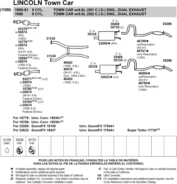

Get a resonator put in....... Some luxury cars have them from the factory quietens down the exhaust..... I know my town car has them..... With out them they are quite a bit louder.... The ones that are on the TC look like glass packs..... But they are not.
I had a Flowmaster kit on my 1999 GMC Sierra 5.3l it had a resonator under the cab to keep things quite under the cab. Right at the axle is where the noise started.... Right about half way the muffler..... Anything before that point was quite...... You barely could hear the exhaust at once you got in third.. However since flowmaster does not make a stainless steel system for my truck I was forced to look else where.... I put a borla system on..... MAN it sounds GOOOOOOOOOOOOD. I find myself turning the radio down and listen to the mellow sounds...
Edgewise see the attached pictures one is the Lincoln system I spoke of... The other one is the flowmaster system I had.. My money would be on adding a resonator.....
