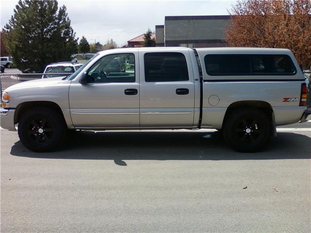

mbc,
I will attach a pic of my 05 gmc 1/2 ton crewcab z71 with 285/70 -17's on it. I got some yokahomma geolander a/t's 8 ply's on it and I did not have to do anything. I did remove my front mud flaps but I think I could put them back on I just havent yet. I also removed the little plastic deal on the bottom of the front bumper but again I did it just in case so the tire shop did not start trimming stuff for me. My wheels are stock wheels off an 07 GMC they are just powder coated. Anyway I hope this helps.
