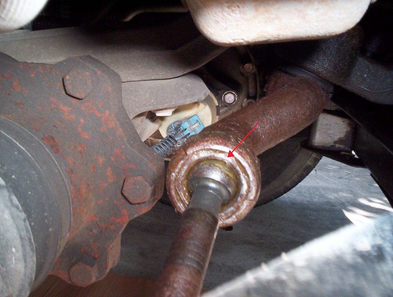

I have a question regarding the inner tie rod ends on my 2005 GMC Sierra 1500. I slid the boot off to take a look and there isn't any play in the ball but the hex piece retaining the ball does turn about 1/8th of an inch. Is that normal/acceptable or should it be replaced immediately? Here is a picture of it so you see can see what I'm getting at.

If it doesn't have any play in it I would not be worried. The hex piece you describe is threaded into the housing right? I believe it should be staked to keep it from coming unscrewed. If so, a little movement should be fine as long as it stops short of unscrewing.
