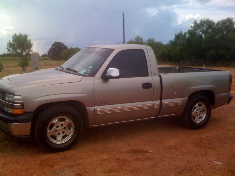

I have a 2001 chevy silverado with a 4.8L. I wanted to take the speed limiter off of it and add a little power so I bought a hypertech programer. My question would be is on this programer is it has the option to set the rpm limiter to whatever you want. I want the most from my engine but I don't want to give it too much causing damage. What would be the ideal rpm max
