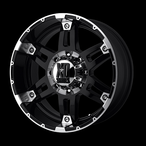

these are the rims i am looking at, any other suggestions for black rims are welcome!
KMC XD XD797 GLOSS BLACK MACHINED
(Series XD797)
one piece aluminum painted
