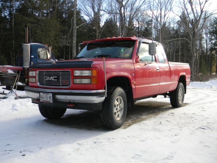

Hi there guys, i have a question that i hope can be answered. i have a 1994 GMC K1500 with a 305 engine. i've had the truck for about two years now and i pretty much know everything about it , except one thing, when i did the first oil change on it, i went to the store and purchased oil and a filter.when i finally crawled underneath i discovered that the filter was completly differant, so when i went back and i asked if i got the right filter, and they said it was the correct one for that year, instead my motor takes a much larger filter, almost a quart!, it takes the original 350 filter,and it screws on vertically instead of horizontally, and i know the motor is factory because i matched the numbers, and the engine isn't rebuilt, 250k and still going! and i know the output isn't an adapter because the original owner said it had that ever since new, which makes me believe it's a goodwrench motor. i just want to know if this was availible from the factory, i do know that GMC trucks had heavier duty equipment. thanks!

If it is a 4WD, they were all built with the adapter and used PF52 filters instead of the PF35/PF1218 filters.
The PF35/PF1218's were only used on 2WD applications of the 305/350 engine.

Hmm, thats interesting, because i also have a '93 chevy silverado that was my fathers that im restoring and it has that horizontally mounted filter
and its a 4x4 w/ 350 Engine. but maybe thats because its a chevy and not a gmc.
Chevy to GMC makes no difference.
4WD horizontally mounted PF52 filter.
2WD vertically mounted PF35/1218 filter.
305 or 350, no difference.
Not true at all,Chevy and GMC's use the same equipment....they are built at the same assembly plants,by the same workers,using the same parts. Other than some trim items (emblems,wheel ctr. caps) and sheet metal,mechanically they are the same.
Like ChevyTech said....GMT400 trucks with 305/350 engines that are 2wd uses PF35/PF1218 oil filters,4wd uses PF52
