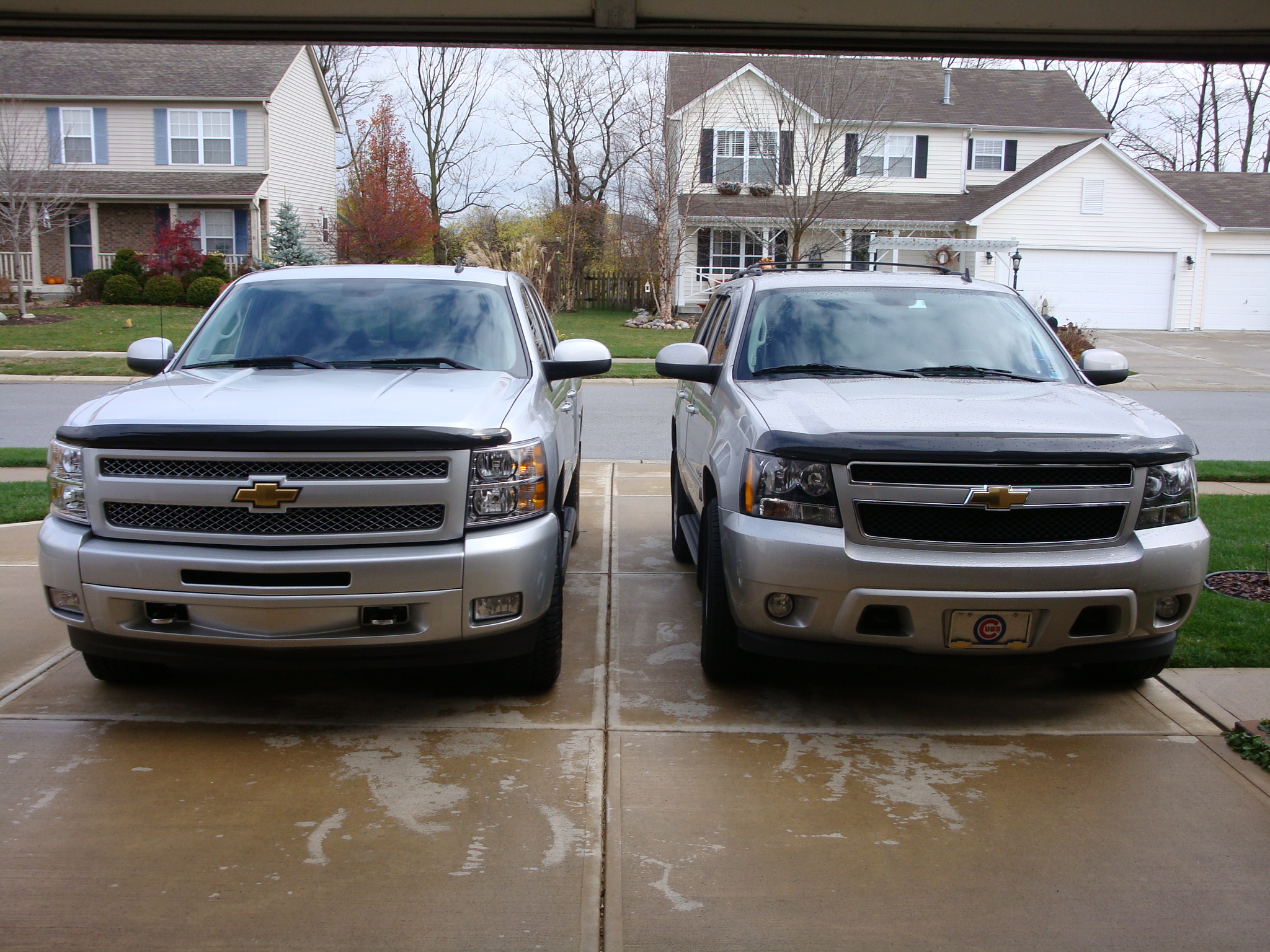

Beeker, we purchased a 2010 Tahoe and a 2010 Silverado at the same time back in Sept. I bought 2 GM hood protectors for the vehicles right away. The mounting on the Tahoe wasn't too bad, but the way in mounted, sorta "clamping" onto the hood on the Silverado was the dumbest thing I have ever seen. I took both hood protectors back to the dealer, and upon doing a little more research, I bought the EGR brand, and couldn't be happier with them so far. The EGR won't actually touch the painted surface of the hood, and doesn't require that silly "tape" to protect the hood. The only thing I will tell you though, is don't get rid of the screws from the GM protector. My GM hood protector used rivnuts, and once those are installed, very difficult to dig outta there. The EGR used the same holes, but a little different mounting design, but using the screws from the GM part in the EGR worked great.
